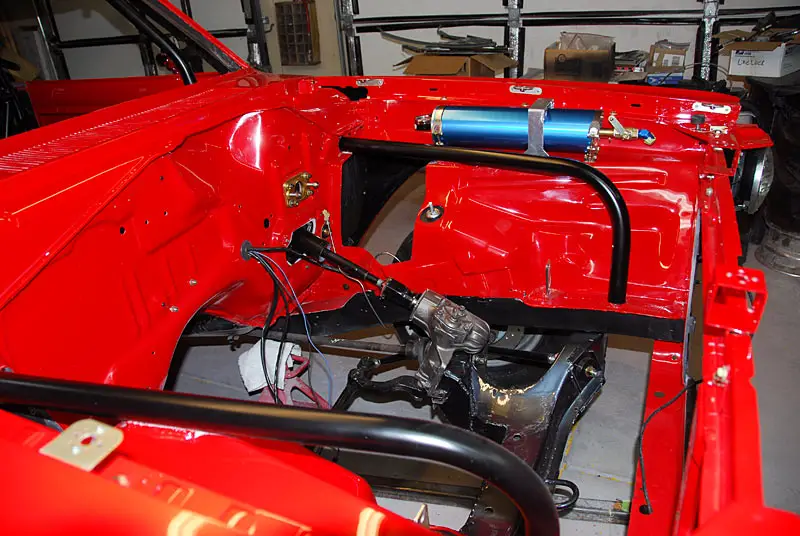

Nice! I'm going to be running the same one:

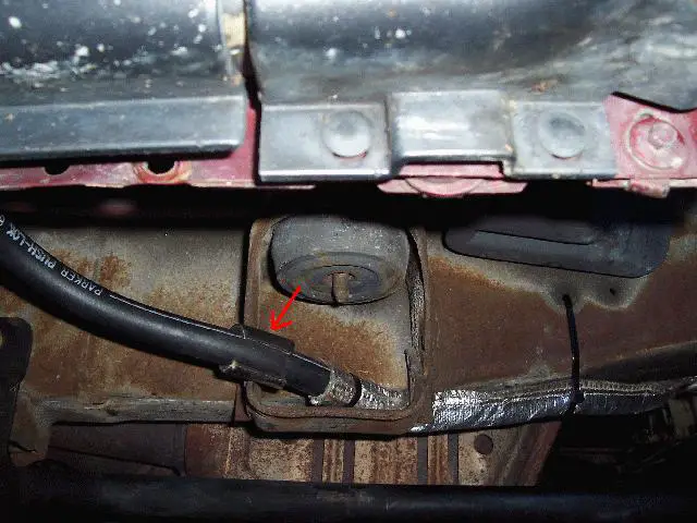

The hose to the Accusump is in close proximity to the passenger side exhaust downpipe and catalytic converter. To protect it from the exhaust heat I installed some heat sleeving as shown in the photo below.
The hose is routed downward next to and then under the frame rail.
The photo below shows the hose routing on the accumulator side of the frame rail. The red arrow identifies a section of larger diameter hose that I inserted to prevent the oil hose from being chafed.

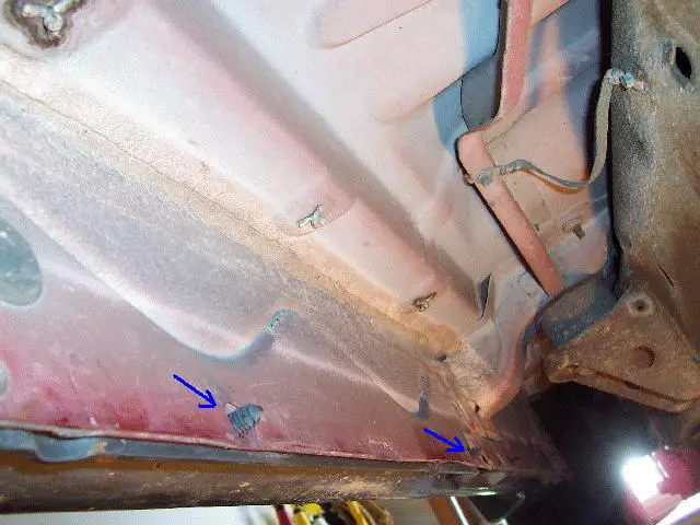

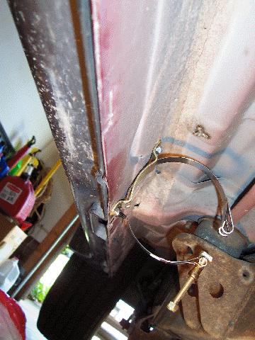

Since I had previously removed my side steps I decided to mount the accumulator to the inner body underside. There were already two exterior trim mounting holes at the desired spacing and location as identified by the blue arrows in the photo below.
The frame rail is a sturdier alternative mounting location.

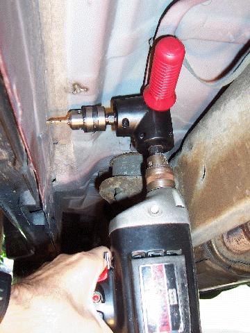

I had to use a right angle drive as shown in the photo below to drill the upper mounting holes for the Accusump supplied mounting brackets.
I mounted the top of the brackets with hex head sheet metal screws and the bottom with black trim bolts and locknuts as shown below.
The Accusump instructions state that the accumulator can be mounted in any position but that mounting the oil end slightly higher than the air end will prevent air from accumulating in the oil side. I mounted mine horizontally. I decided if I periodically let all of the oil discharge from the accumulator prior to start up the piston would displace all of the air on the oil side. I can tell when all of the oil has discharged by watching the oil pressure rise and then drop after turning on the ignition.

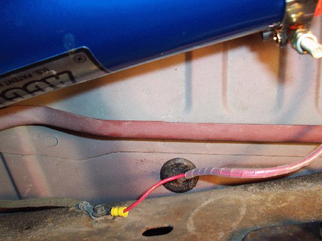

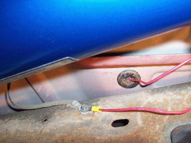

The ground strap lug shown in the photo below is convenient to utilize for the Accusump. I soldered a terminal lug to the solenoid ground wire and attached it to the frame rail.
There is also a body plug in a convenient location. Using pliers I carefully pulled the flexible plug down thru its opening. I then drilled a hole thru the plug for the other solenoid lead - do not try to punch a hole or the plug will tear. I ran the lead thru the plug with the larger diameter at the bottom instead of the top. I routed a stiff wire under the floor carpet pad to the opening and then used it to pull the solenoid lead to the desired interior location. I then pushed the plug with the solenoid wire into the opening as shown above.
I wrapped the two solenoid wires with a spiral loom as shown below.

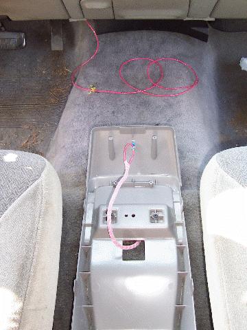

I originally planned to install the toggle switch in the vicinity of the instrument panel so I removed the side trough panel and routed the wire in it as shown below.

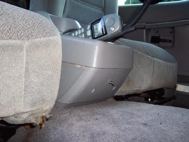

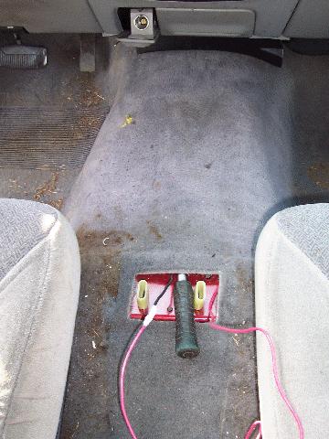

However, I could not find a suitable place to mount the toggle switch so I decided to mount it on the center console. The center console on my Sport easily comes apart for removal. But it is very difficult to thread a wire under the carpet pad at the transmission tunnel. I was forced to remove the front seat mounting bolts as shown below in order to lift the carpet and pad.

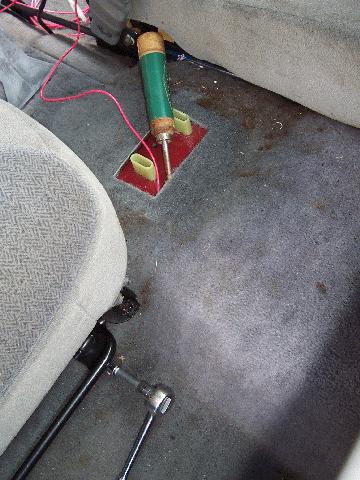

The next step was to thread the power wire from the console area forward under the carpet along the top of the transmission tunnel. To raise the carpet pad I attached a long extension to my 1/2 inch breaker and taped the two together to prevent separation. Then I forced the breaker bar assembly under the pad along the path for the wire as shown below.
With the wiring for the toggle switch in place I drilled a hole in the front of the center console base, soldered the wires to the switch, installed the center console base and switch and wrapped the wires with spiral loom as shown below.

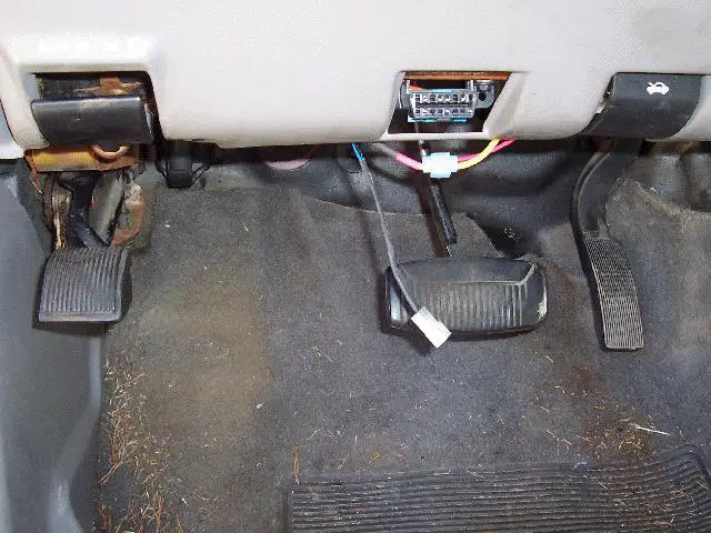

I already had an ignition controlled power source from wiring my wideband air/fuel ratio meter. I merely connected to the source using a trailer type quick connect as shown below.
The other wire/connector is for data logging the analog output of the A/F ratio meter. I cable tied the wires together and tucked them out of the way between the bottom of the OBD-II port and the lower instrument panel.
The photo below shows the switch mounted in the center console in the enabled position.

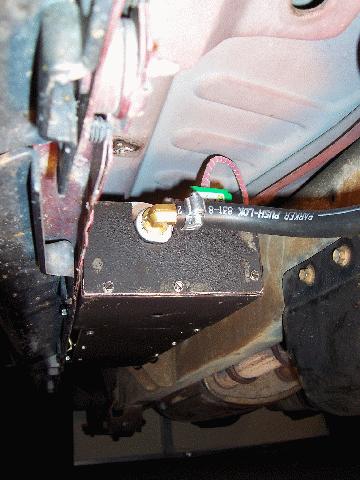

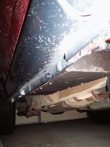

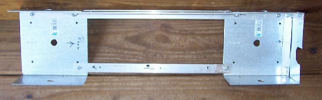

I didn't want to expose my new Accusump to rocks and road tar so I built a protective cover for it. I constructed a frame using 6x6 post anchors and aluminum stock as shown below.
I cut the front, side and bottom out of sheet metal.

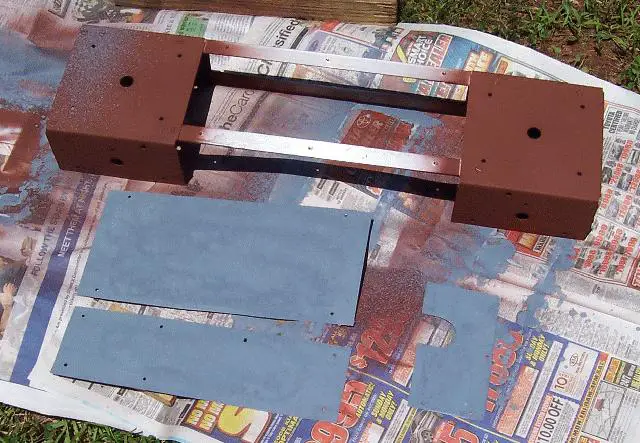

I sprayed rust preventive primer on the components.
I also sprayed the components with undercoating.
