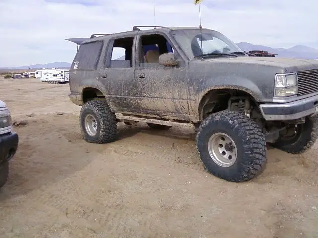

...Just got back from a Truckhaven trip and was so proud that my X came away unscathed..Well, almost...
...The morning we were to head home I found my right rear tire had lost pressure and was about flat...These are a brand new set of 4 KM2's and they hadn't even seen the highway yet until this trip...I did a quick inspection both inside and out looking for the usual signs of gashes, gouges, slits, etc...
