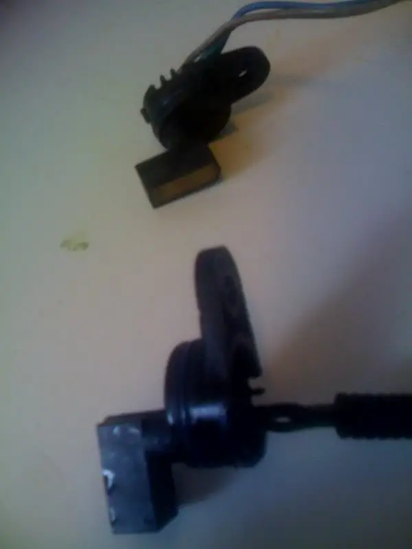

Can someone please post a picture of the upper sensor that is behind the shift motor on the transfer case. I changed my 4x4 module, but still getting the blinking 4x4 light. I want to swap out the sensors, but don't know what the top one is supposed to look like.
I went to Napa and they showed me a bunch of sensors that came of for my truck, but I had no idea which sensor belongs on the top half of the transfer case.
My truck is a 2002 4.0 xls. NOT AWD.

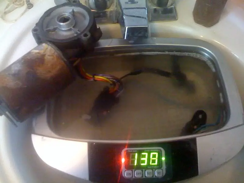

I unbolted the shift motor and tested it by selecting 4 low and the motor turned. So the motor is not seized or dead. I then took it and the upper (rear shaft sensor) and lower (front shaft sensor) out for a cleaning. I used my ultrasonic cleaner.
I put it all back together and reset everything with the battery unhooked for 10 minutes. BUT still nothing (4x4 light blinking.

Also that shift motor looks pretty beat, did you keep it connected and test it to see if it was turning

Just superficial rust. It is solid with no real corrosion. The part that spins the shaft was very clean. It turned when I selected 4 low and back when I selected Auto.
Ok thanks for the update on the brown wire voltage. The ground wire was perfect. All the wires looked very good. The cleaner removed any debris or oxidation from the pins on the end of the wires.

Installed both new sensors. Everything seems to be working fine. Drove a around a bit on my snow and ice side streets. Giving it a little gas I could hear my front tires spin and pull me up some hilly areas. Just before the fix I could barely get my truck up my driveway, because the rear wheels would just spin on the ice and snow.
I believe now that the dealer never replaced my sensor. I bet they just cleaned and reinstalled it. I can't prove it, but just feel that is what they did.
I honestly do not know which sensor was bad of the two changed. I would say for something like this changing both sensors together is good practice, like changing a pair of brake bulbs at a time. It will also save you the hassle of going under the truck a second time.
