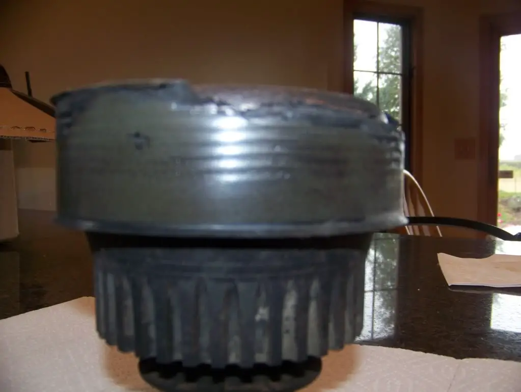

Well, I too have succumbed to the notorious failure that is this balancer. This is ridiculous. I have no idea how long the pulley has been like this or how it even ran at all. I am just glad I found it before it totally let loose while driving....
Grooves for the belt are nearly 100% smoothed:mad:
