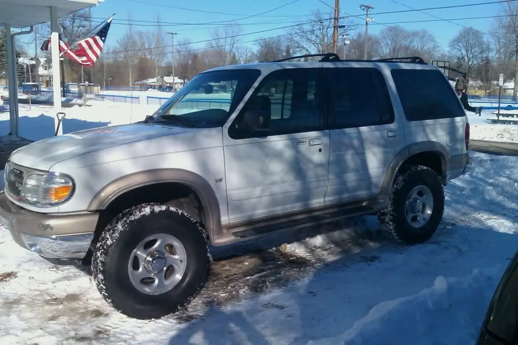

lol i got to learn this pics thing.....
needs a bath and a screw in the front airdam.......
LOL the icebergs got the best of the bumper the last couple weeks at the mounds
thanks
nice eddie u got there
what do u have done to it as far as suspension? also, what size 33's? sorry for the questions, thats just what i'm wanting mine to look like
Well you can see aftermarket shackles in the rear, so I assume he's running shackles with a T/T.
Btw, I'm an Ohioan...don't you love how our parking lots always look like communist Russia after like one or two seasons of winter?....ugh. I hate that.
3" BL, Shakles TT, to level it out, and 285/75/16(32.8/11.2/16) stock wheels........little bumper trimming/running boards to fit(only the front)

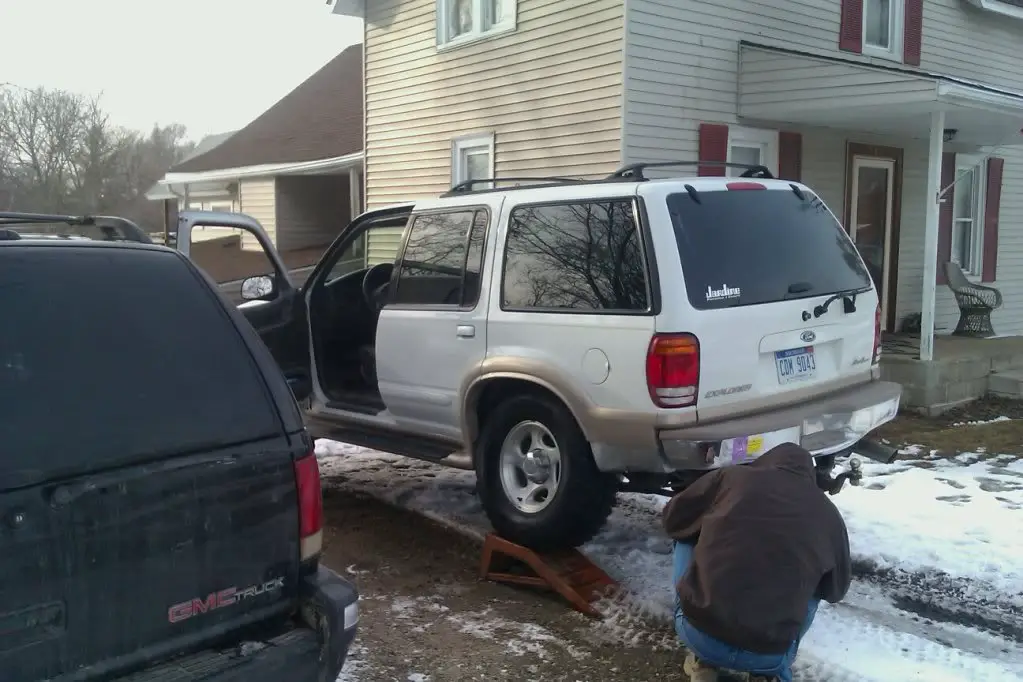

Did u use the ranger pa883? Lift? How difficult was the install? Any helpful hints?
USEd KIT PA883
Couldnt get the steering shaft undone so we did it after the lift, aloud it to pull apart when we lifted the truck.(unbolt it still) make sure the wheel is locked it wont move.....(airbag problems)
i cut an unused tab on the radiator(rightside) to get it to fit....
use an impact if you have one....
use the rear stock bolts in the middle(what the write up says
took 2 guys 5hrs(GOOD BACK YARD mechanicS)

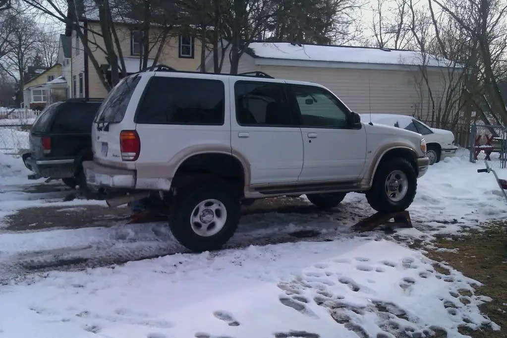

little flex

How much trimming did you have to do to the front bummper and step ?? Im lifting my Eb and just wondering on how much i need to do.
