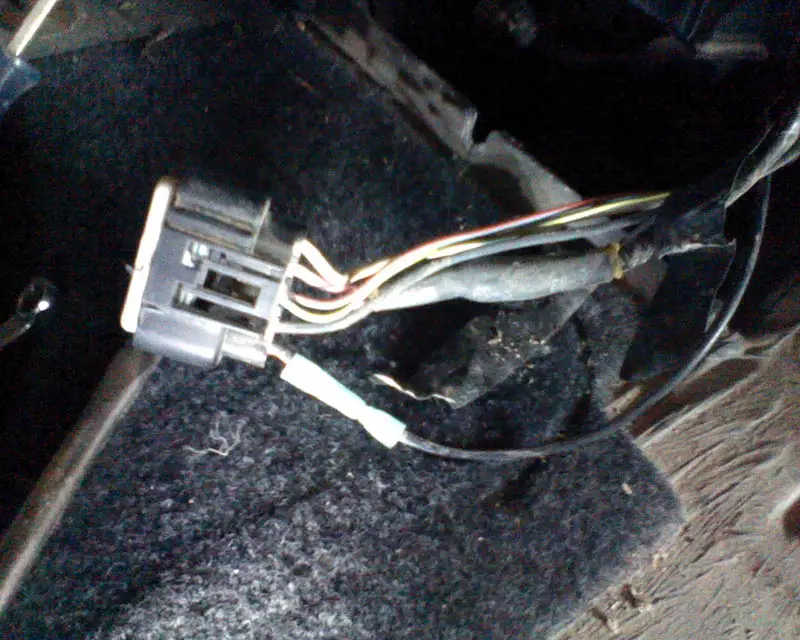

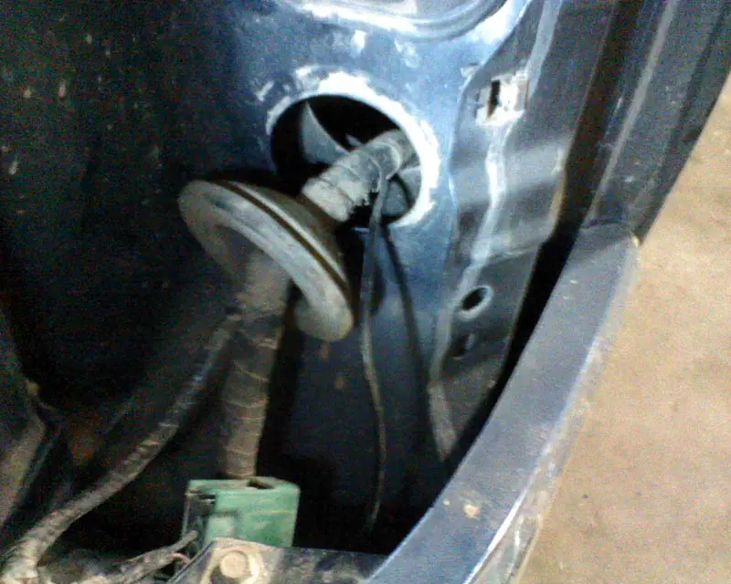

Thanks for all your help ncranchero. I have finished repairing the Explorer tonight. Your wiring diagrams were very useful in determining how to go about diagnosing this system.
First of all this Explorer was plagued with intermittent fuel delivery problems from the very beginning. All the dealership could figure was to change the fuel pump.
It was driven for a couple more years with this till it finally died for good then the local mechanic found a broken wire in the harness and run a jumper wire for the floating ground between the module and pump, as shown.
Now a year later it died again and now my turn at figuring out what's going on. First I find a blown fuse sometimes indicating a bad fuel pump, so I pulled the tank and removed the pump. I dried the gas off the pump and safely wired the pump to the battery to see if it works, and it did. This is where I learned of the fuel pump module. I used the wiring diagrams to bypass the module by jumping the White wire with the Pink and Black wire for the positive,and jumping the Black and Orange floating ground with the chassis ground Black wire. I reinstalled the fuel pump in the tank and then plugged it back in to the harness. Checking voltage with a meter at the jumper connections I got 12 volts at the jumper connection but still no fuel pump (the fuse didn't blow this time) this tells me that the fault lies in the harness. What I noticed in the schematic was that these wires were shielded, so all I could guess is that the positive wire was grounding against the shielding in the harness and blowing the fuse at first. To fix this I run another jumper straight to the pump connector and now all is good.:thumbsup:
