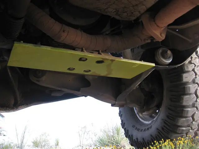

Many years ago, we had the Cat replaced and that is how they did it.. They just cut the pipe just downstream of the flange (still in the bulge), squished a 3" pipe and welded it into there.
Since then, we have had the Cat moved downstream a bunch to get it away from the transmission (700r4 was too close to it).. Our Cat is now by the transfer case (protected by that skit plate too).
This is the only pic I can find that you can see the flange. This was before we went to extended Radius Arms.
RA bracket reinforcement by maniak_az, on Flickr
You can see how far back our Cat is now. I don't know if you can get away with that where you are, but at least around here, it still passes visual emissions tests and the sniffer tests.

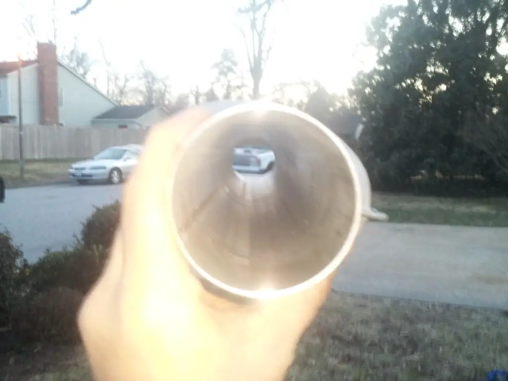

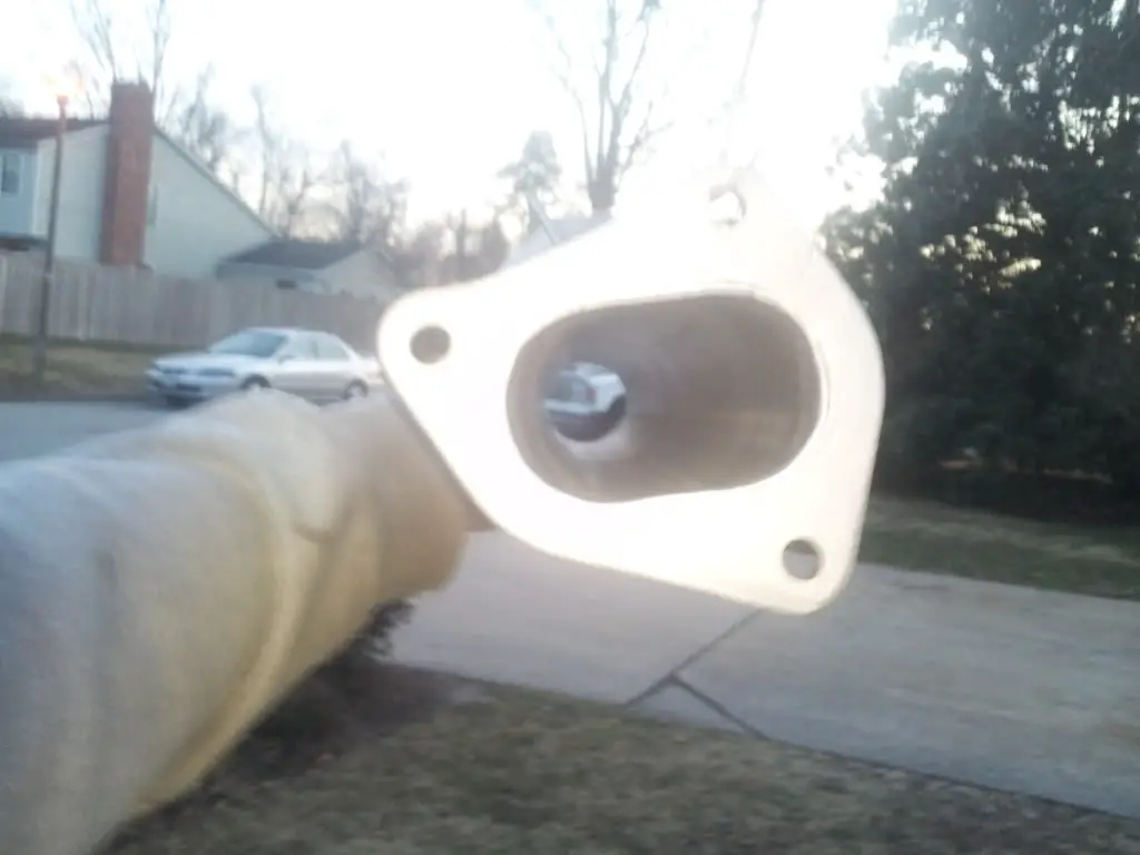

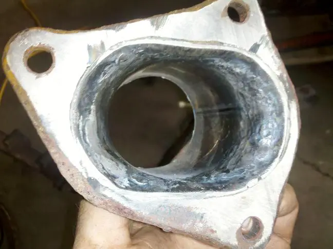

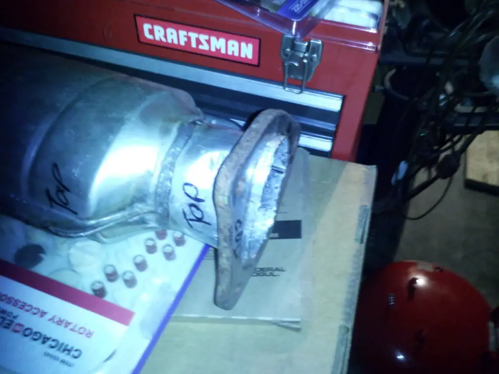

Attached is the flange I made to use a plain aftermarket CAT. It connects to strait pipe (2.5") so any commonly available aftermarket CAT should work.
I used a 3" to 2.5" header reducer, dropped it in the old stock CAT flange and formed it with a hammer. Lots of gentle whacking to form it! Then I removed a bit of extra material that stuck up to much, tacked it, then welded it up.
If you do this at home, try to remember that the stock CAT does not feed strait towards the rear. Your new adapter needs to be a bit **** eyed to get the stub pointing in the right direction. So some trial fitting is probably a good idea.
In my case the engine was out of the truck, so I used another Explorer to compare angles with.
Also, the factory y-pipe has a 3" or so oblong pipe sticking out of the rear of the mount where the stock CAT goes. This must be removed to mount a flange like the one I made. You can see it in two of the attached pics with a black rectangle around it... after it was removed. lol

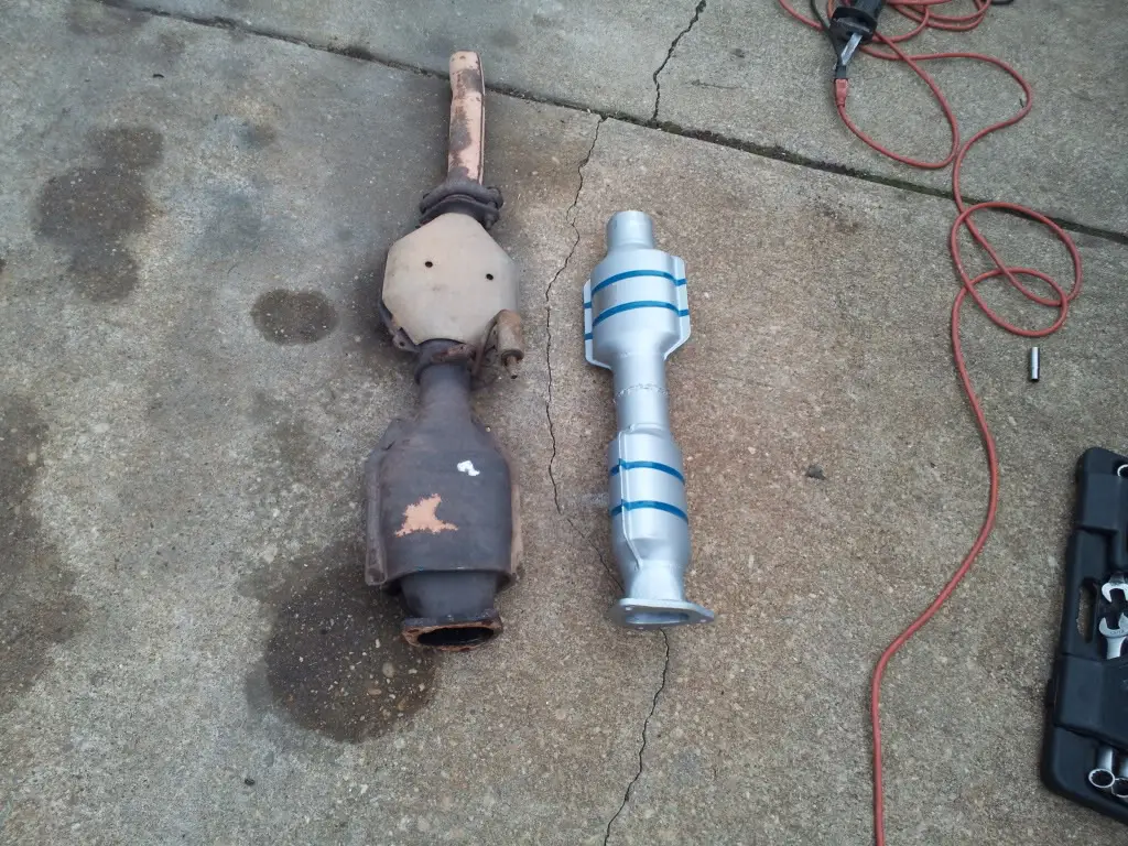

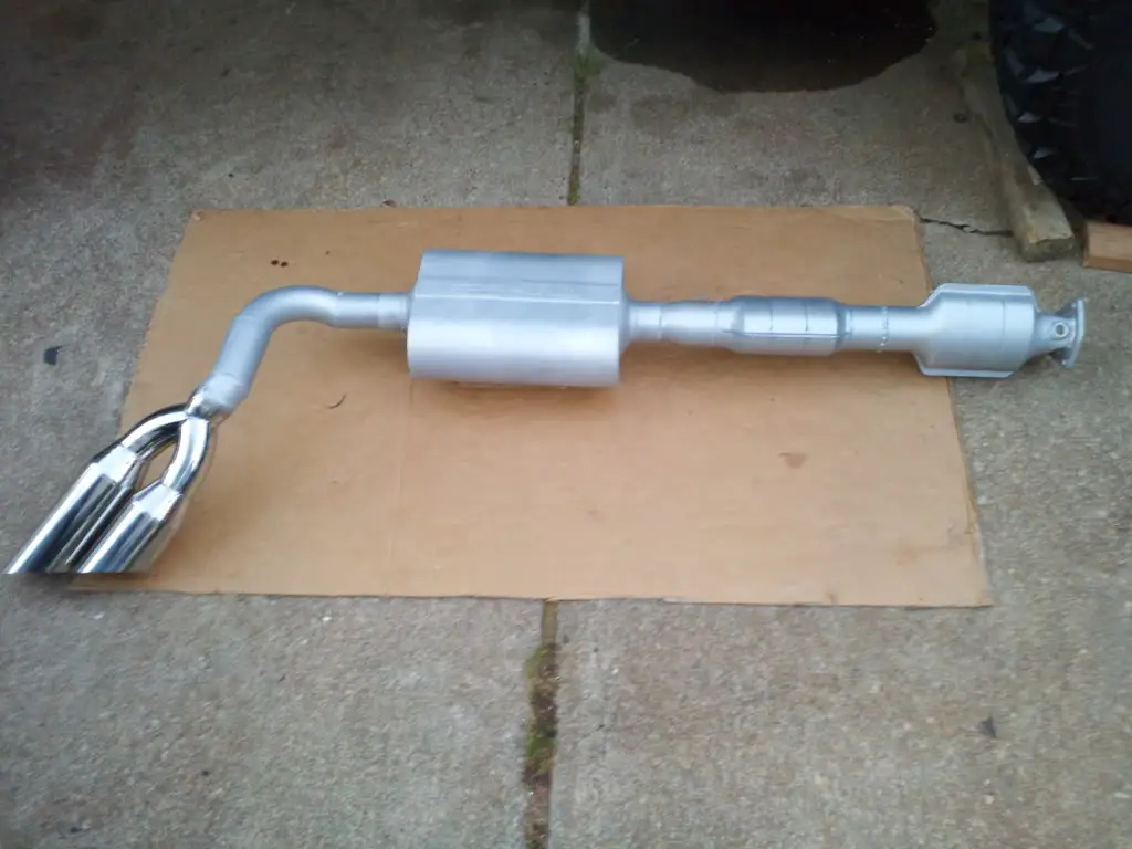

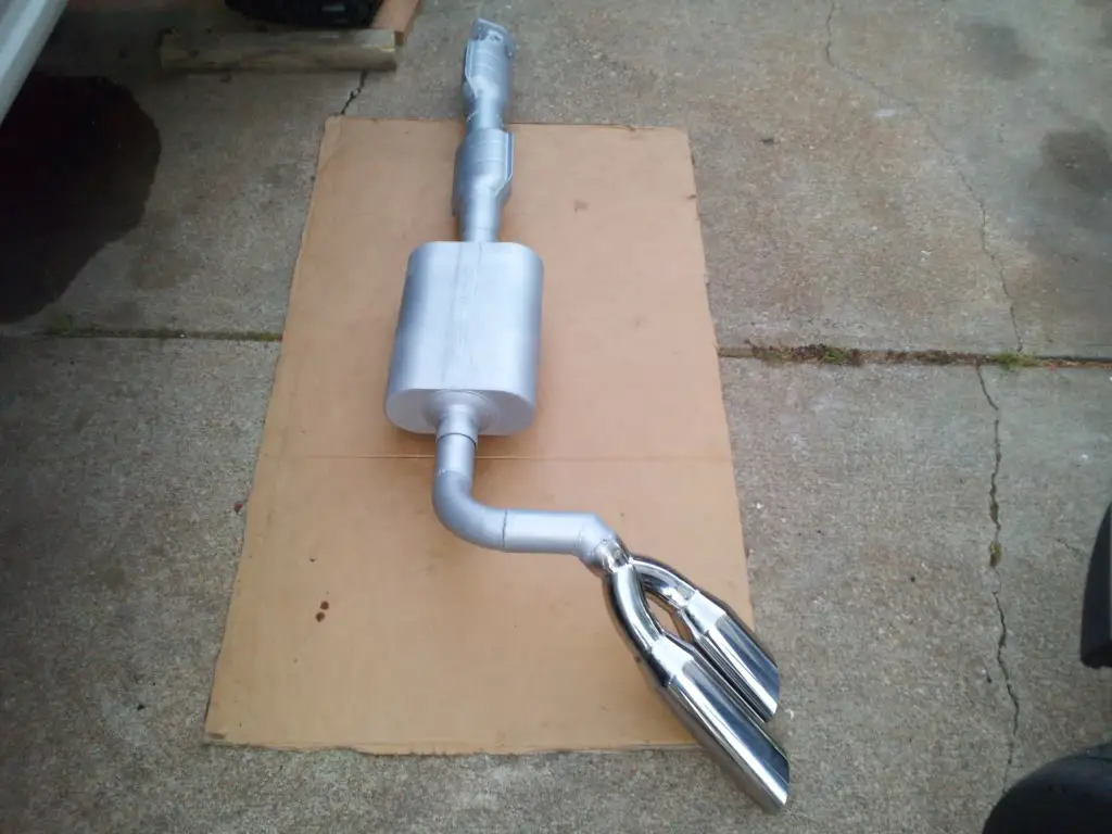

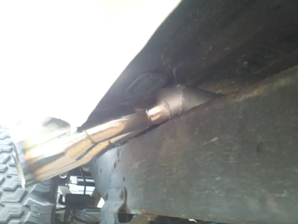

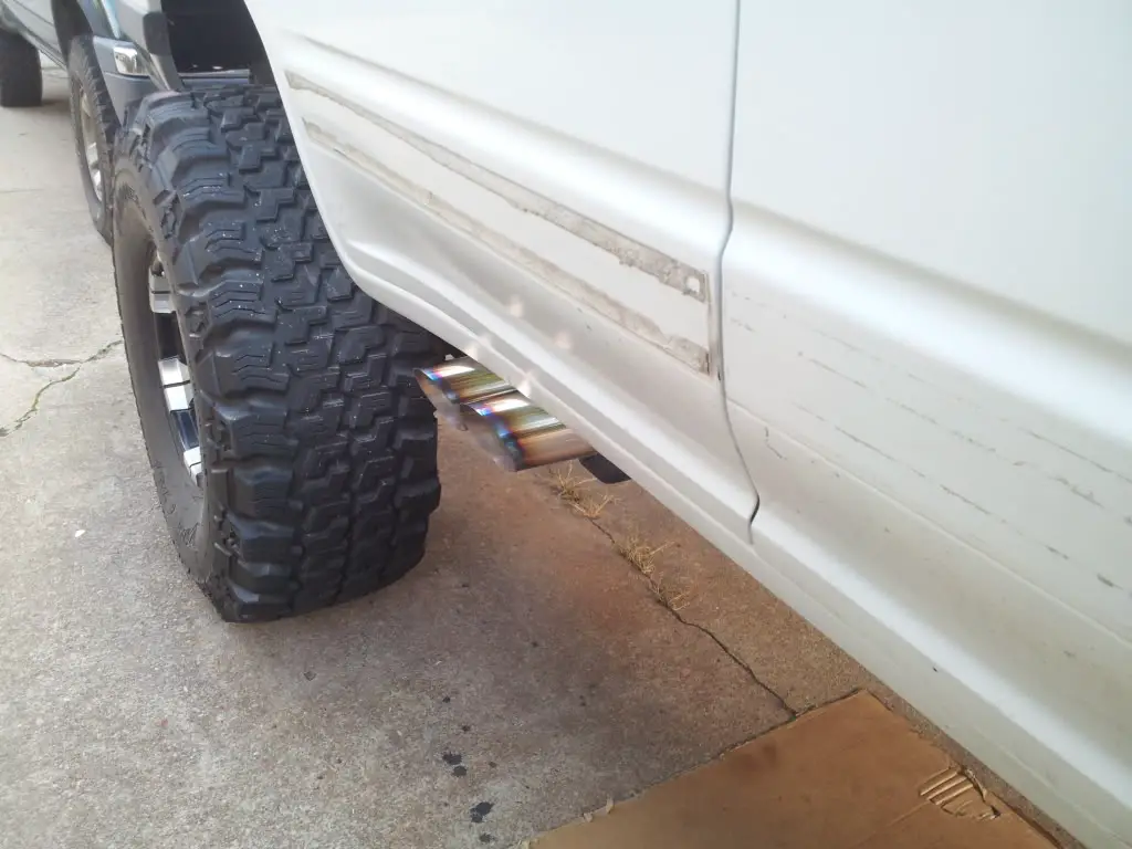

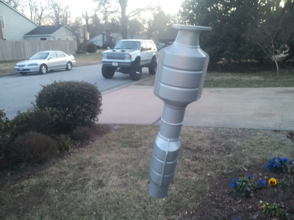

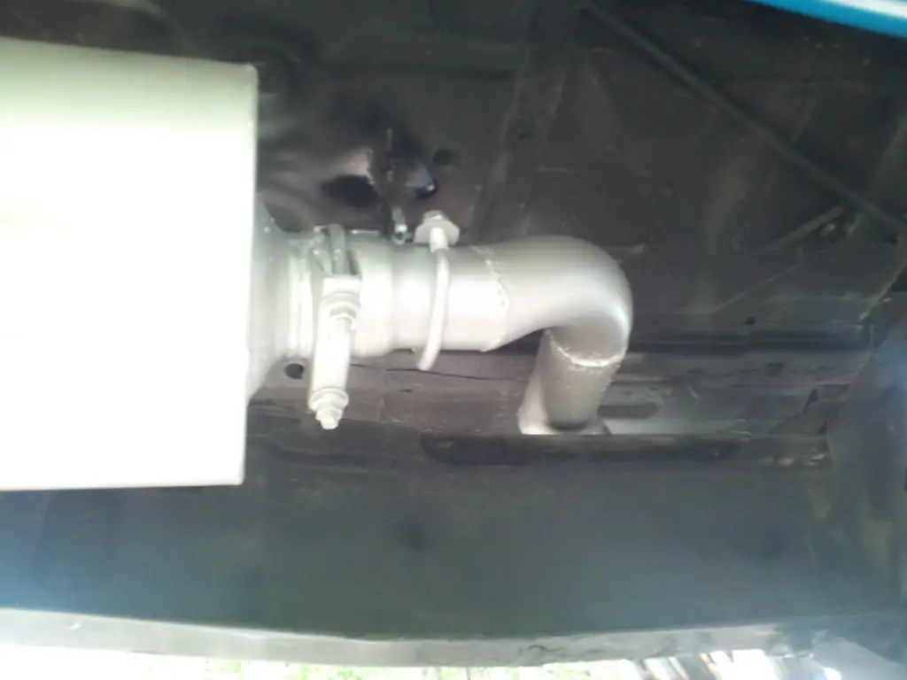

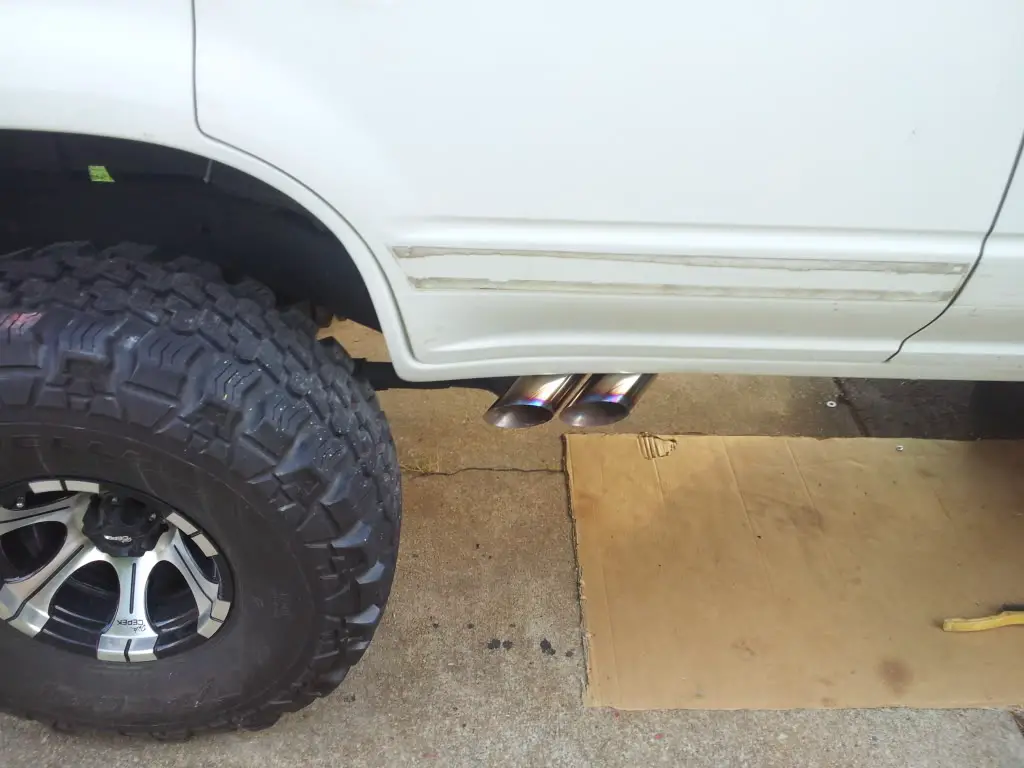

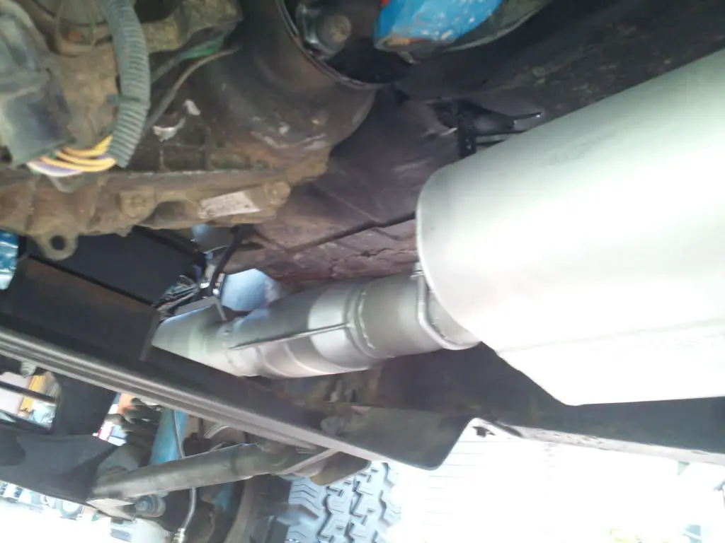

i just built my own exhaust and did same as nedwreck did.before i go any farther this is a OFF ROAD TRUCK ONLY!!just posting some pics for ideas with using LEGAL cats!!!i cut the flange off the old cats and used two fake 3" cats,the 3" pipe fit in the flange after some hammering.the rest is all custom so i wont go into to much details.but basicially its reduced to 2.5'' into a flowmaster 40,then over the frame to dual 3.5 slant cut tips.
