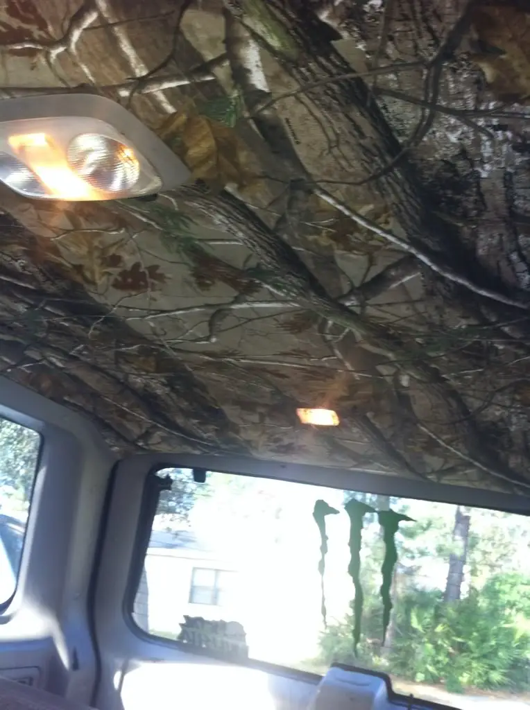

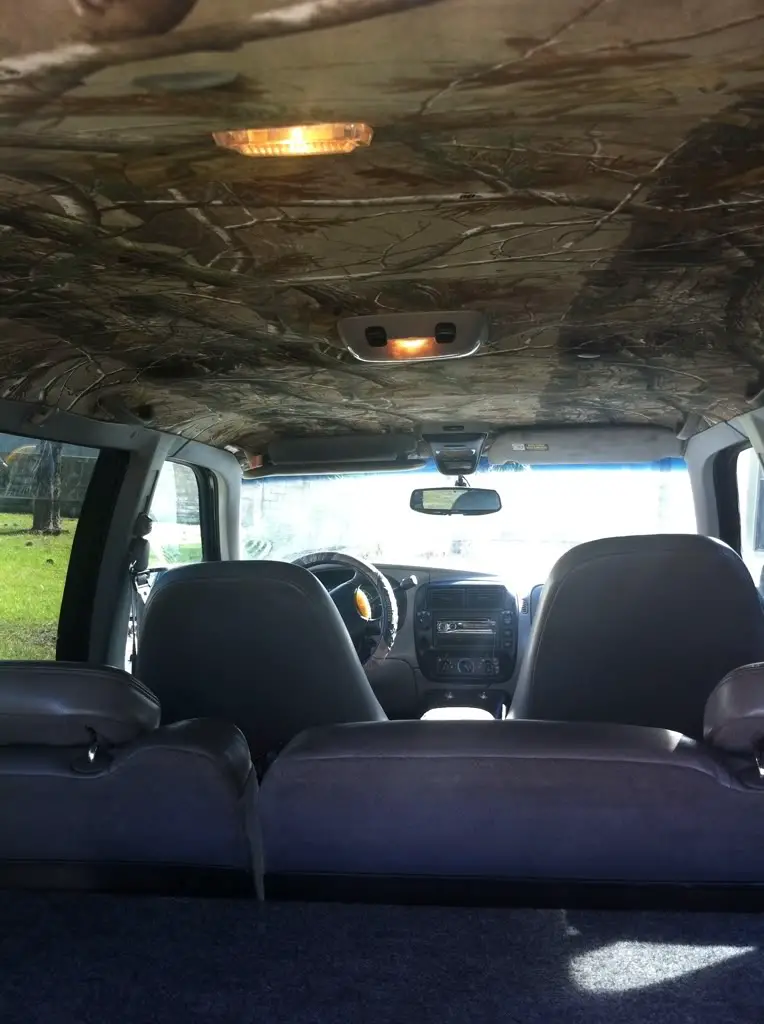

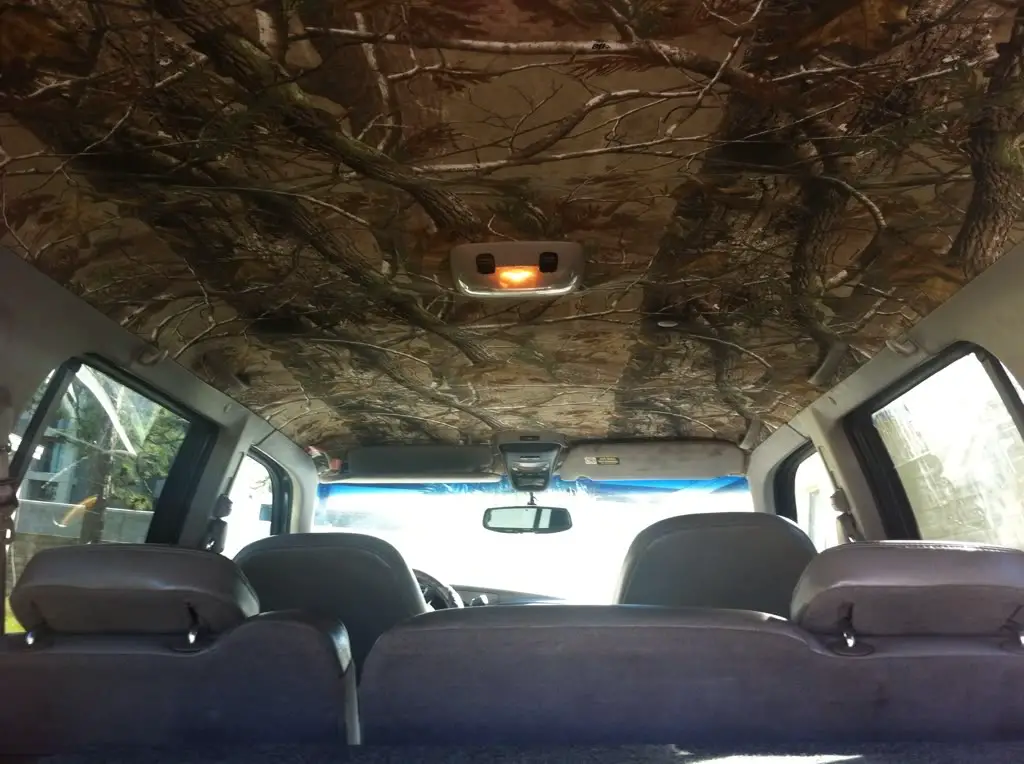

I did a real tree headliner in my 97 ex! Came out awesome!! I just took the headliner out completely, bought a few yards of the fabric from Jo Ann's and 2 cans of spray adhesive. I then layed the fabrics onto the headliner, gilded it back, then started in the middle and worked my way the the ends.. Injust stuck it to the headliner that was already their and it has stuck great so far!! I've had it for a few months now and hasn't started to fall or anything! It took me about 2 1/2 hours to do. Was not hard at all!

Thanks I love it!! I'm gonna do part of the doors and the visors next!! And i recommend 2 yards and it will leave you with a little left over.. I got mine from joAnn fabric store.. I'm not sure in the cost my gf surprised me with it.. But I brleive it was about $2 a foot cause I've looked at it before.. I recommended using 2 cans of the spray adhesive

And it wasn't hard at all I did mine at like 7 pm after work... It only took about 1-2 hours
