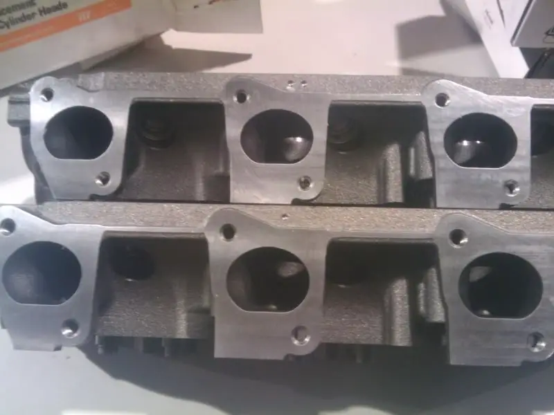

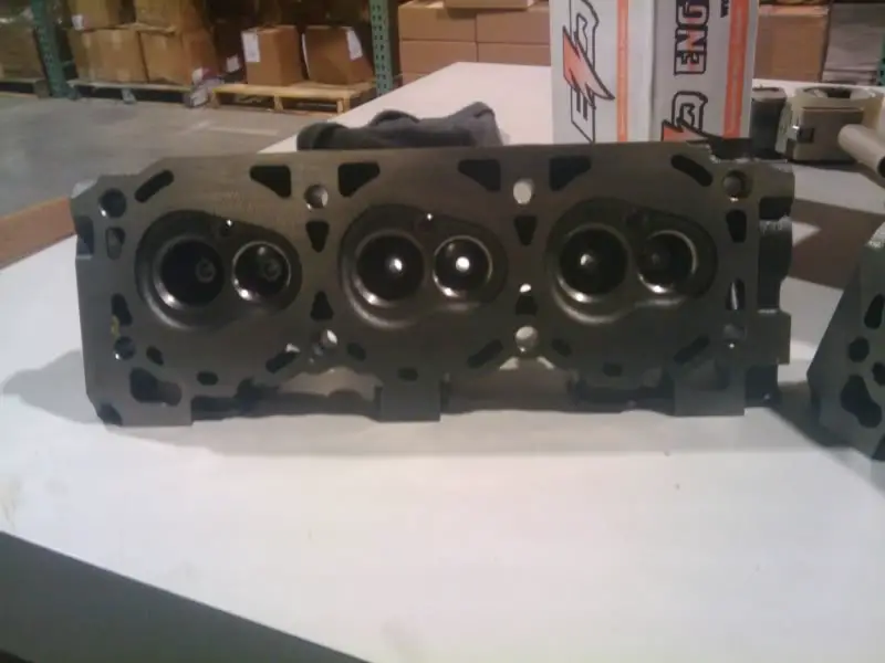

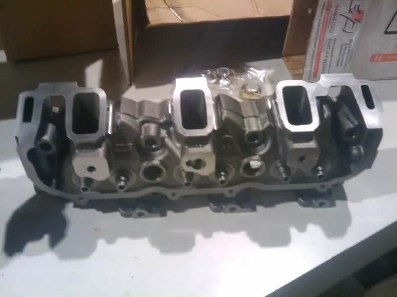

http://www.ebay.com/itm/FORD-EXPLOR...Parts_Accessories&vxp=mtr&hash=item20ad93e8df
i can vouch for this seller. mine came from him and were perfect out of the boxes
Just remember that the above ebay seller is selling bare heads. If your just doing a stock rebuild, grab a set of assembled heads to toss them on..
