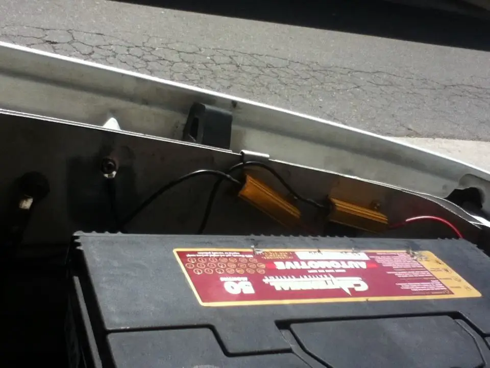

I attached the relay harness right by my Fan. The relay harness with give the ballast power and stop the 12v Pulsing. I drilled the first 2 orange capacitors attached to the relay harness right next to my battery and against the metal for heat dicepation (They get hotter than your momma). Then sand the frame of your truck where you will ground out each capacitor. Run all your wiring where it should go. Retro has a pretty descent wire diagram online. I followed that for the most part. A lot of vehicles when hids are installed only one of the OEM headlight plugs are used, or at least thats what the diagram showed. For our truck the other wired capacitors are needed on the other oem socket to not throw a check light on the dashboard.

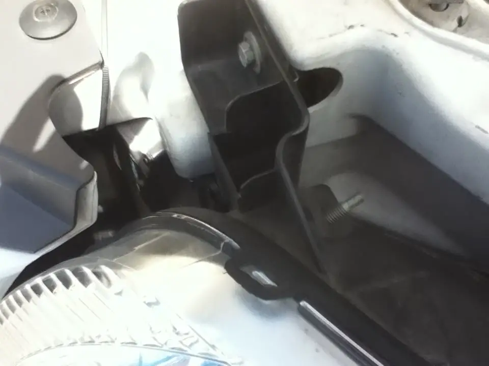

The installed pictures:

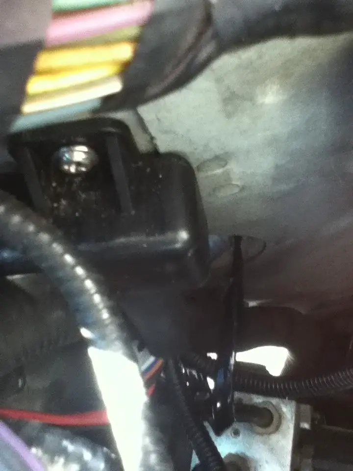

This is the relay harness the gets power, connects to the both ballasts and the light bulbs, and has the set of capacitors.
This is where I mounted the ballast.

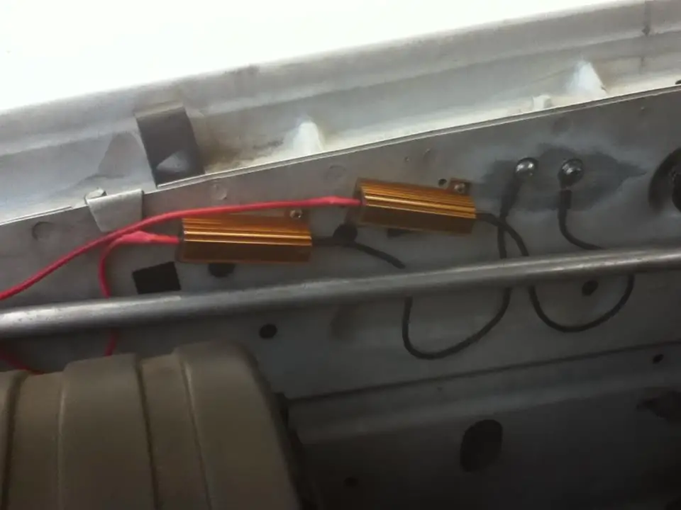

These are the capacitors that are connected to the relay harness. (The other ground is mounted just to the left off the pic next to that bigger ground.)

Good write up. I have 3 questions. On the driver side, do you have a picture of the (+) red cable connected to harness. The reason I'm requesting this is because I have bi-xenon hid kit on my 2007 explorer and I plan to buy resistor, to get rid of "check headlight bulb" on dash. I want to install them correctly. Where did you bought your resistors?
I see one (-) cable is grounded to body of suv, where the other negative cable is plugged?

The + red wire is the power, its connected to the battery. The black - wire has a plug at the endof it. The two capasitors plug into that wire making the ground a double ground with capasitors. You ground those out to the frame. Like wise to the other side but ithe two capasitors plug into the oem light socket. I got the kit from retro solutions. I will post more pics later today
