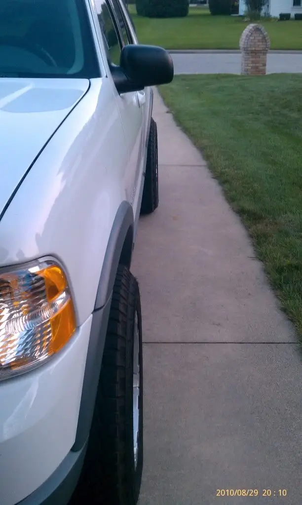

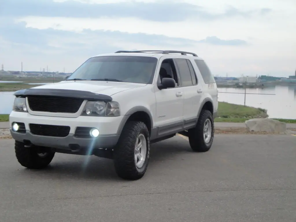

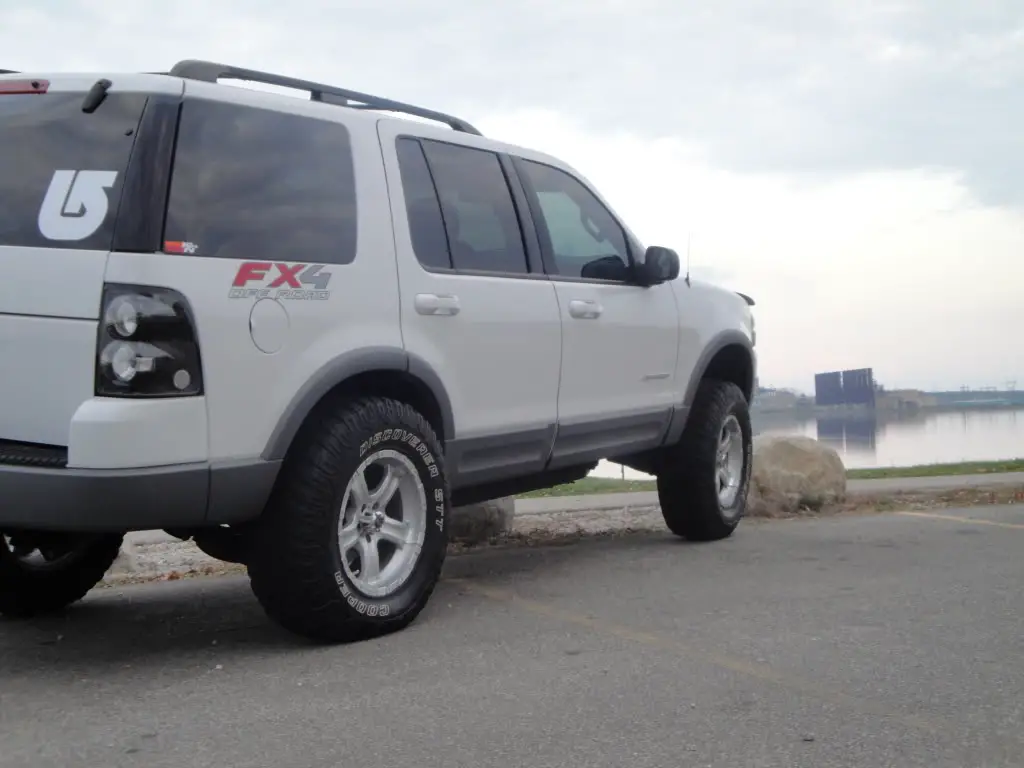

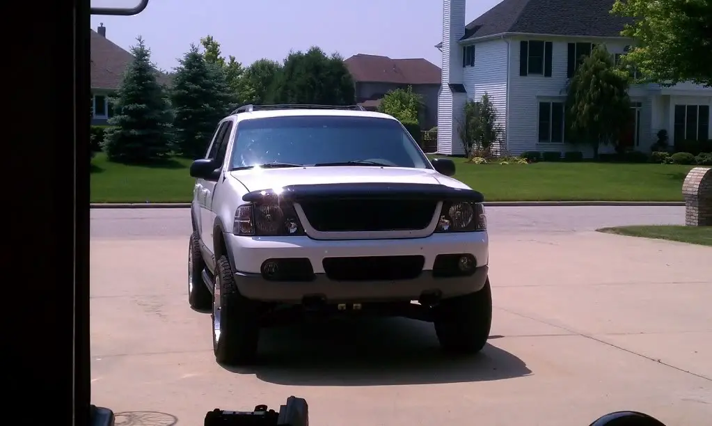

Shouldn't be too much. Here's an older pic of mine with a 1.5" body lift, 265/75/16 tires with 8 inch wide wheels that have 0 offset (so sticking 6mm further out than the wheels you're looking at):

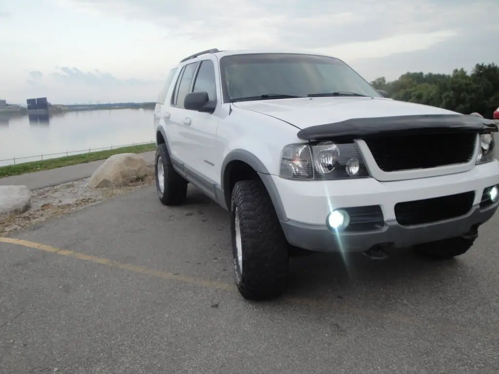

17x8.5" rims -6 offset
20x8.5" +18 offset

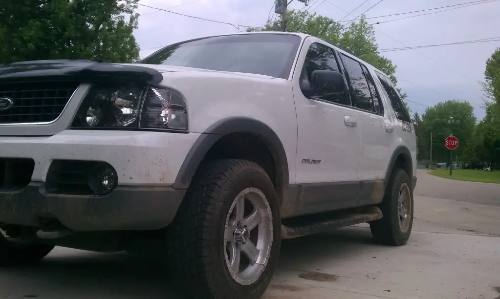

heres my -6 offset rims without lift

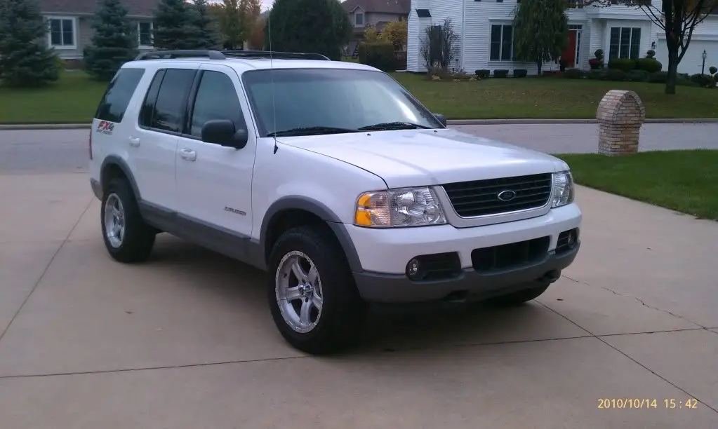

and here is with a 1.5" bodylift only. 245/65r17s
