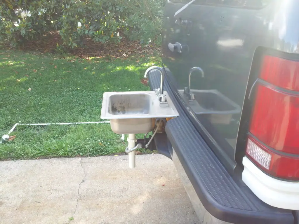

Well i wasnt going to release this yet till it was all the way done but figured why not.for you that know me know i did what i was calling the "power house" witch was the dual battery,ac inverter,and 110volt compressor with a 8gal tank.http://www.explorerforum.com/forums/showthread.php?t=333598
well ive added to the on board capabilities,OBW on board waterits a 26 gallon tank with quick disconnects so i can switch from a hose or for the OBS(on board shower) i plumed it all so its inside the tailgate.just open it up,attach the shower head and plug it in.the other main reason i did this mod is for when i get off the trails i can plug my ac pressure washer in and wash my tires,rims and breaks off.or in the case we are at the beach i can give the truck a quick rinse to get all that salt water off.i haven't decided on a pump yet,really thinking about just getting the cheaper 5.5gpm one.the shower head uses 2.0gpm and the pressure washer uses 1.5gpm.its only 26gallon tank so im looking at a 13min shower or about a 17min car wash.ive painted the tank black so it can gain some heat and being in the truck all day will make for a slight warm showerfor you worrying about weight,so am i,the 26gal should weigh around 208lbs and all the other stuff for the power house weighs a bit to.i have aal but thinking about taking it out and getting 2'' lift springs.
ill post more pics or vids when i finish
