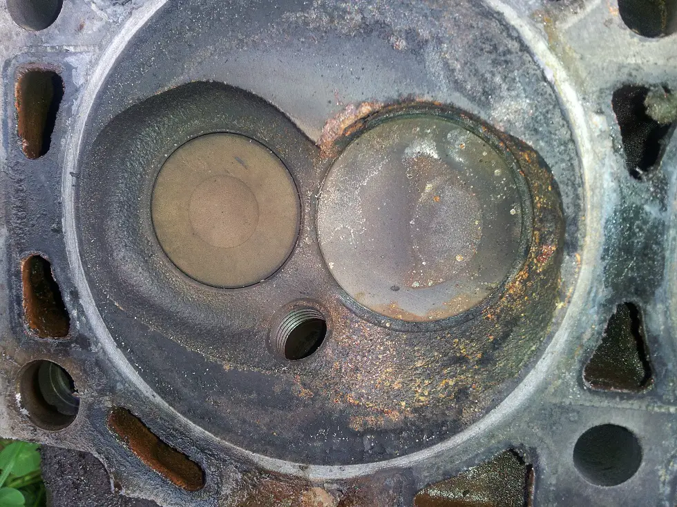

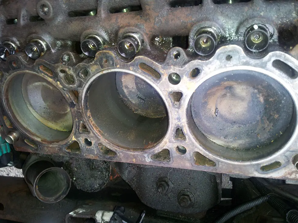

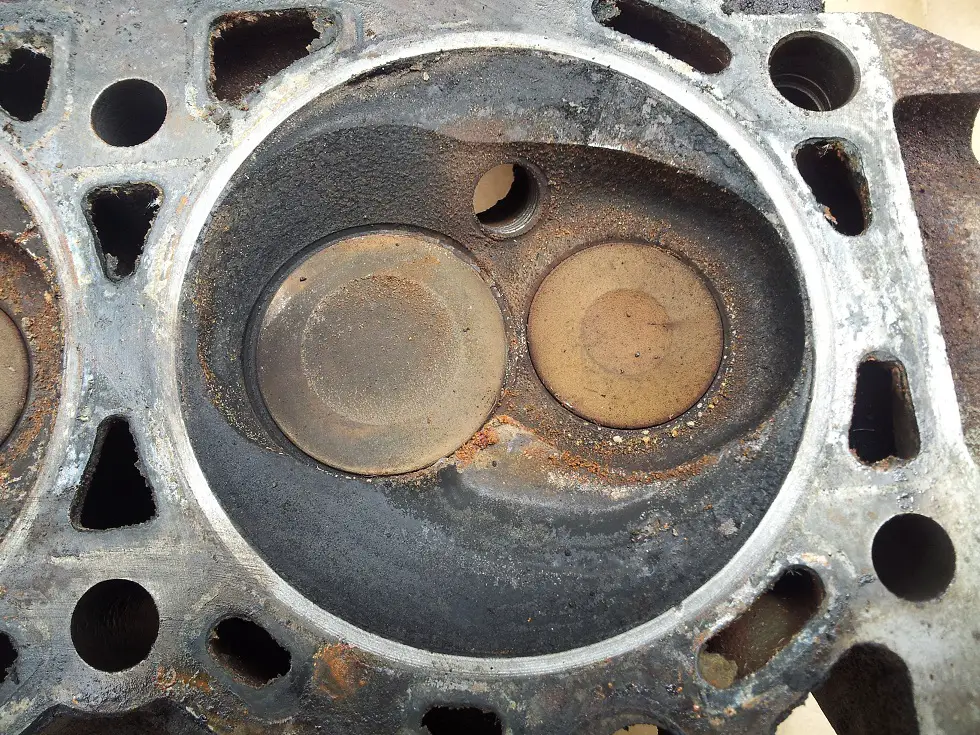

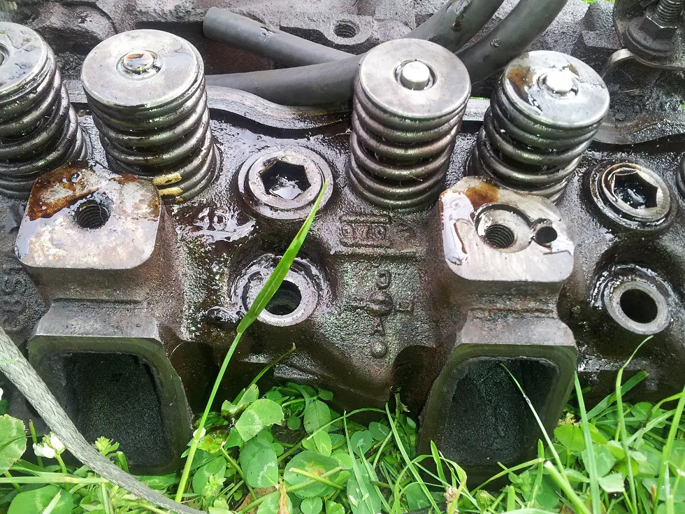

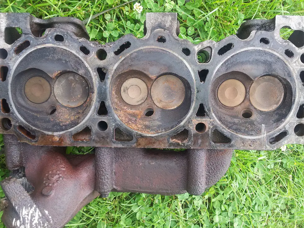

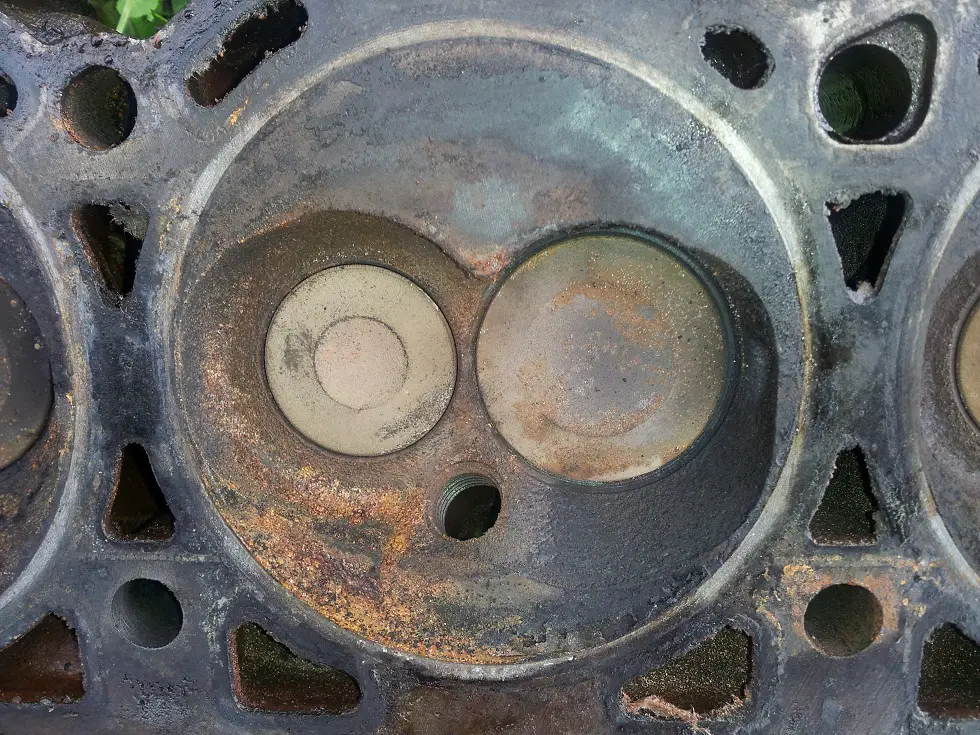

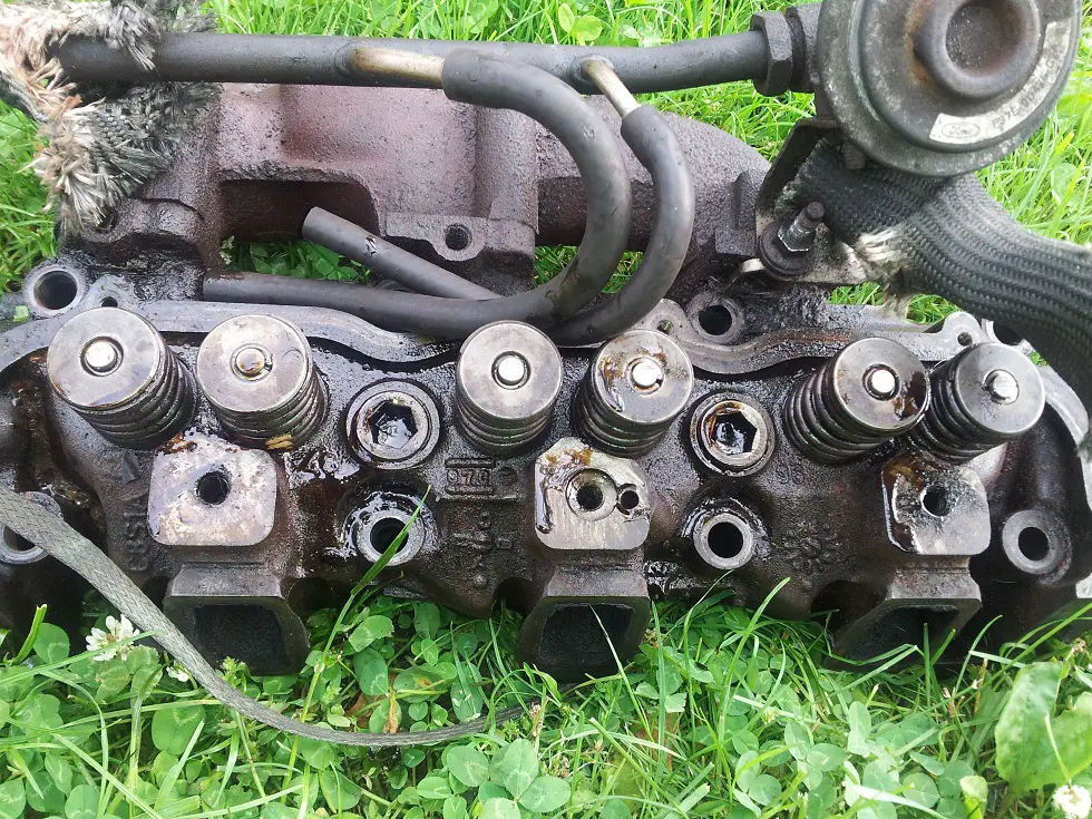

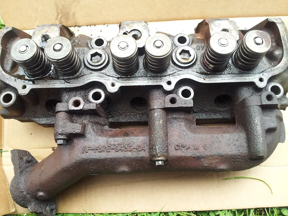

So after fighting through that, I have both heads out with exhaust manifolds attached. I see no cracks in my heads (cast-iron) so I was not planning on replacing them...unless someone thinks (based on my description and the linked pictures below) that I definitely should??
I figured I will get the 3 pieces of bolts left in the manifold to pipe out of there and get replacement bolts to re-attach after I change out the gaskets.
Is it a bad idea to think I can put these heads back on? ALso, should I clean and/or lubricate the cylinder/piston heads? Any advice based on the pictures would be greatly appreciated, thanks in advance for your time!

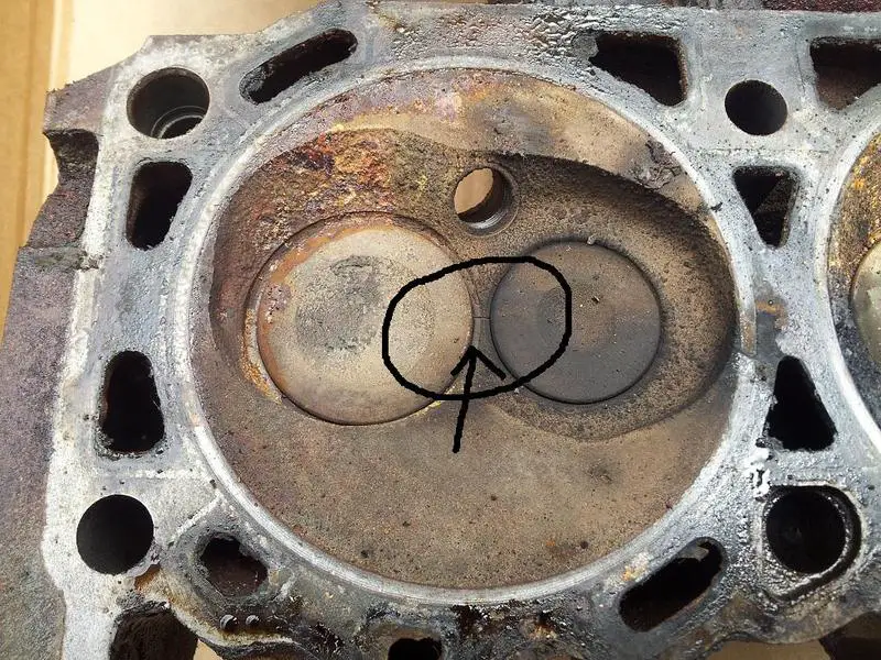

i see a crack .....between the intake and exhaust ports
wow Thanks Joe!..Definitely good eyes! I'll be ordering new heads, although I saw prices in the $225-275 per head range (new/complete w valves) not $700+ that you've seen Bengal...
I've looked all over these heads, I can't seem to find the 95tm casting code, I've looked by the spark plug holes, I have, however, found the 'U' casting mark that I've read means the 95tm or 97tm (identical) heads. Is it possible the heads don't have the '9Xtm' marking?
I'll be ordering new heads and exhaust manifolds (manifolds form Rockuto).
Thanks again!

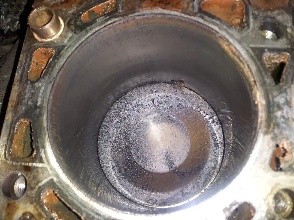

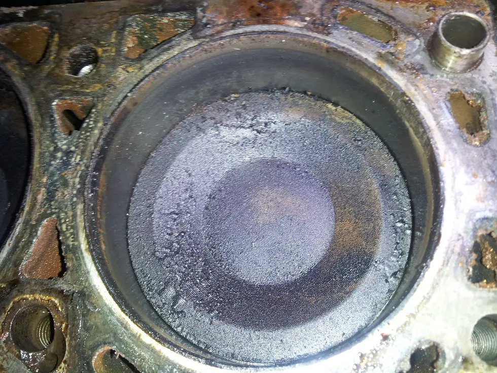

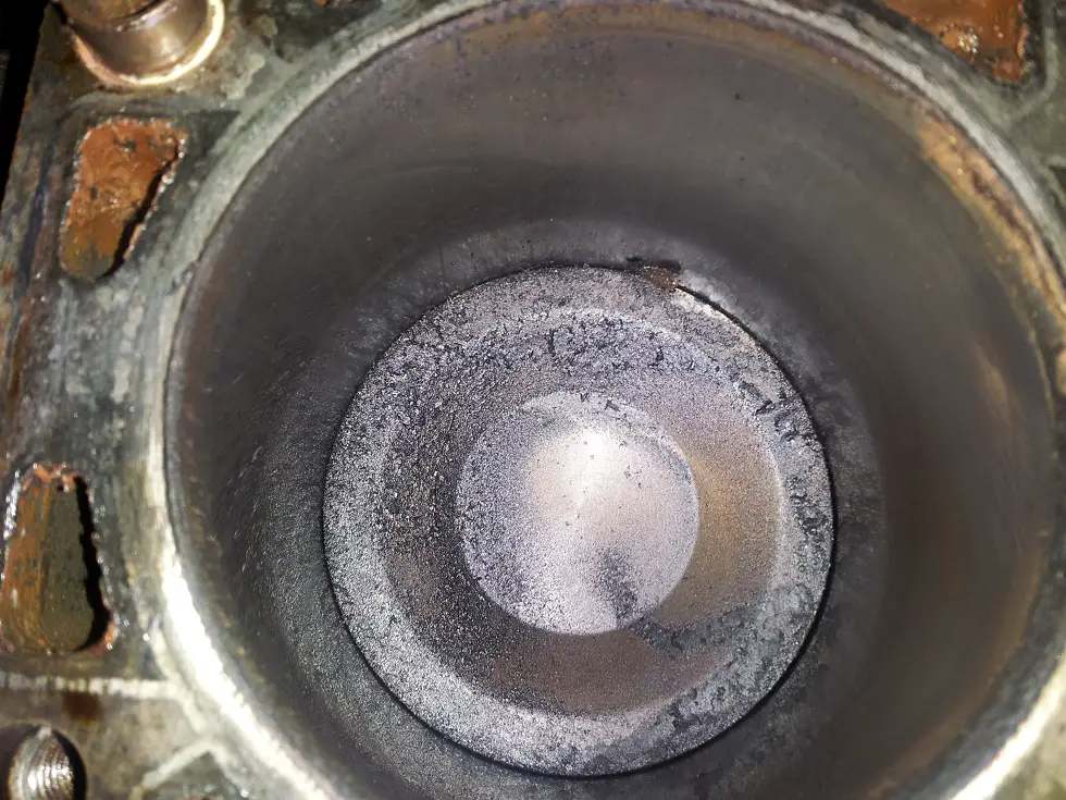

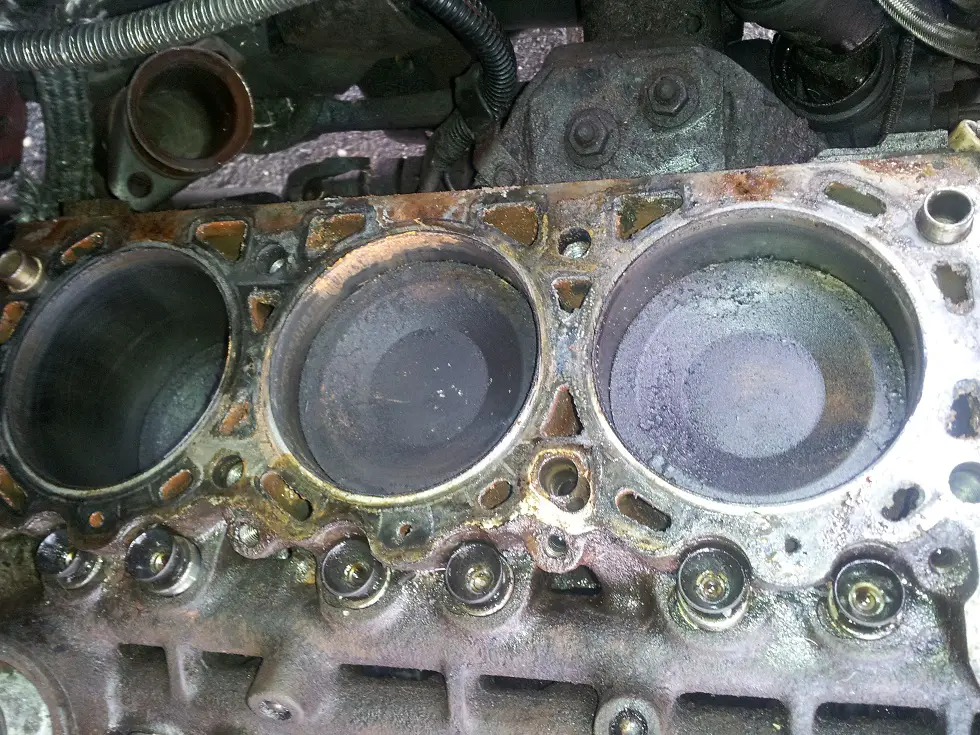

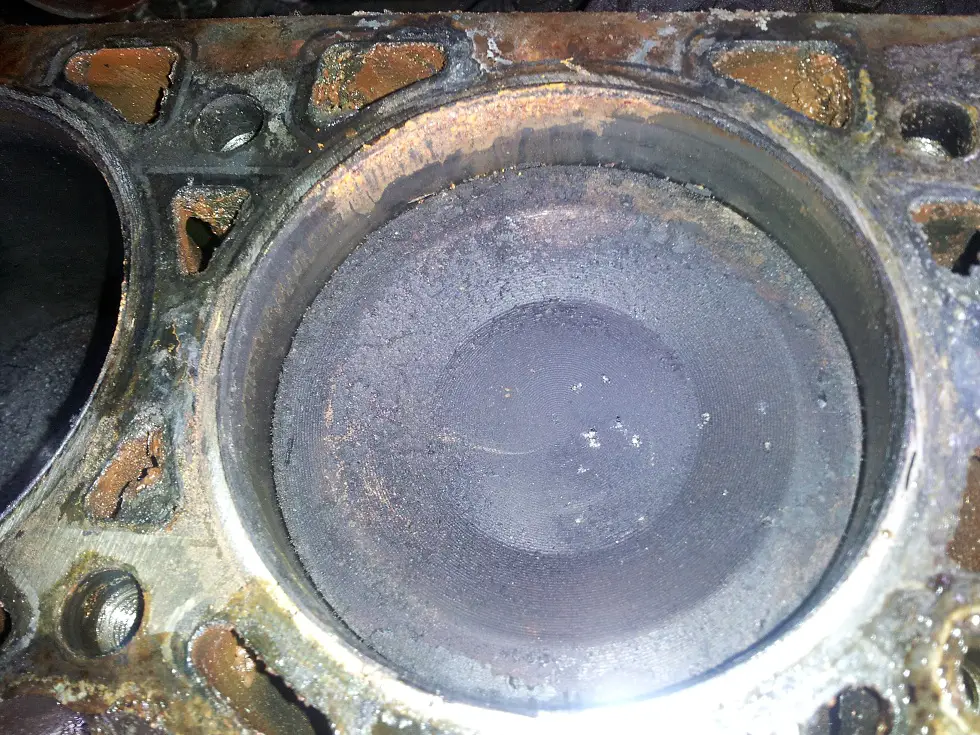

I'm not sure if it was already there or drained out of the heads when I wrestled them off, but 3/6 of my pistons had a good amount of anti-freeze laying on them. Good amount of carbon buildup as well, can I clean the top of the pistons with Acetone or something? or should I even bother?

I asked the same thing about cleaning the cylinders, I would say obviously soak up coolant thats in the cylinders and try to clean the carbon as much as you can with somethng like brake cleaner spray

You will need to make sure the gasket surfaces are clean, and make sure you vacuum all loose carbon out of the bores before rotating the main assembly. if you can loosen and remove any carbon without scratching anything, do so.
Just before reassembly, oil the bores with a clean rag, and use something like brake cleaner on a rag on both sealing surfaces on the head and block.
