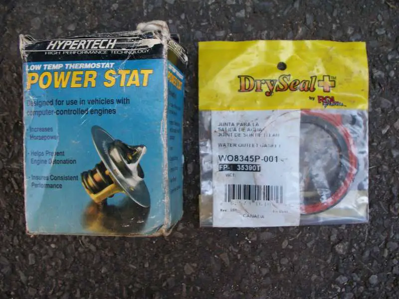

We've had some nice warm weather this summer in NY this year. My 1995 3.0L van's temperature gauge usually rests in the middle during normal driving. Lately it's been warming up faster than usual, and during acceleration it's been climbing up a little too much. Last week it actually hit the H on the gauge even though I had the heater on to help cool it down! :fire: I don't know how old the thermostat is since I'm not the original owner, but I would assume that it might be the original just like most other things on this van. These are the parts which I chose to use since I originally purchased each one for a different vehicle a while back, and never used them:
This gasket cost more than the regular paper gaskets but it's much better quality. You don't have to use any gasket paste, and it's ready to use immediately. It's much thicker than the thin paper gaskets.
