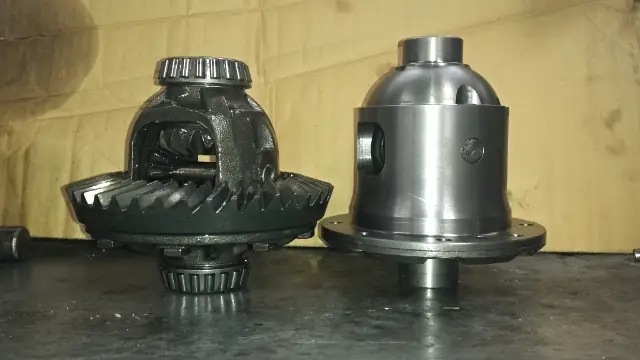

Im in the middle of installing an ARB Air locker RD102 which I thought Its the right application for my Explorer 1997 and it has a Dana 35 on the front and same time I am changing the gear ratio into 4.56....
I have double problems...
first the RD102 seems too high compare the original diff center (shows on the picture)

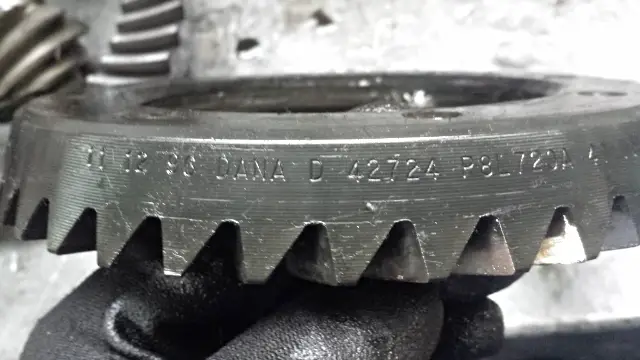

second I thought the front diff has to be reverse gear which I ordered but it seems its not at all... (shows on the picture)
I thought I did my research before all this project but now I am stuck and don't know where to go and my plan was to finish it everything by this weekend but now I have replaced the rear which was no issues but the front I am stuck....
PLEASE GUYS HELP AND WHAT FOR ME TO GET... which Air lockers is suitable for my front and the ring gear and pinion is ment to be just a normal not reverse right..?

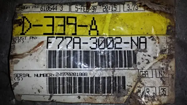

still going around the bush trying to work out what type of Diff I have on the front, I have been ordering Air lockers and E-Locker but they kept giving me a wrong part...
I assumed I have a DANA 35 with 3.73:1 Ratio but not certain If have a DANA 35 or something else....
I have checked around the diff but no sign of a type.... all I have is this (picture below)
and could not find what it means...?
PLEASE HELP!
You have a DANA 35 IFS with standard rotation.. The TTB front end is reverse rotation (1st gen explorer)
Also, there is no carrier break on the explorer front diffs, they all use the 3.55+ size (when something can be used in the jeeps they will show a carrier break)
I looked at the aussie locker application guide (http://www.aussielocker.com/downloads/dana35_bom.pdf) and the 1997 explorer front uses the same aussie locker as a 1997 ZJ so, the only thing I can think of is your getting reverse rotation stuff?
The reason I'm thinking that is AFAIK, the carrier break doesn't change the width of the carrier, just where the ring gear sits..
Before I forget, some places call it an AMC 35 instead of Dana 35.. no idea why...
hopefully that helps...
~Mark

thanks for the reply...
I searched and searched and found nothing and no one can come up with a straight answer and just found out there is no such thing a front locker for gen2 Explorer beside Auto locker...
I have returned both lockers I bought and end up ordering an Auto locker we call it Lokka here in Down Under, I hope it user friendly because Ill be using this Explorer for outing's with my family..
We see how it goes and I'll let what I think about this Auto Locker, Lucky Summit Racing helped me out for all this trouble and they end up sending me a replacement Ring gear Standard Rotation Urgent....
thank heaps Mark... ;)

There are no carrier brakes in the d35 ifs. I am not sure what carrier you received but it's definitely not the right one. The gear set you received looks to be reverse rotation and you need standard rotation. I have a feeling your new parts are for a high pinion ifs dana 35 (pre 95 explorer) which are not the same as an ifs low pinion dana 35 (post 95 explorer).
Most of the lockers from the jeep dana 35 will work in the ifs dana 35. It's going to measure up identically to the one you pull out of the stock housing in size.
An AMC 35 and dana 35 ifs share the same gear sets and bearings, not positive on the carriers. Last I checked other than lunchbox lockers or a torsion l/s there is no selectable locker available. Oh and I am pretty sure Aussie locker got bought out, hence the reason they are hard to find. I think spartan bought them.
The gear set you received looks to be standard rotation and you need reverse rotation
I'm 99% sure that backwards. I remember it as TTB front ends use reverse rotation and the true IFS (2nd gens) use standard rotate, like the Jeep rear. I know the TTB is reverse, but I could have sworn the 2nd gen was standard.
~Mark

thanks for the Info... so I guess there is not such a Air locker or E-locker will fir on Gen2 Explorer only Auto Locker..

yes the Aussie locker is same as a Lokka here just different company as USA bought the Aussie Locker and now we don't have that here and its rare but another company opened up a new name called Lokka...
yes the Gen2 Explorer has a standard rotation as shown in the picture, first I thought it was reverse but I have to re-order the standard rotation...

I have checked over and over there is no Air Lockers or E-Lockers to suit gen2 1997 Explorer....
