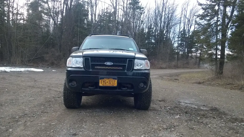

Figured it's time to do one of these.
Bought my trac used for $5k with 130k, about a year and a half ago. It's a 2004 XLT Premium 4x4 (i think) with leather interior, 4.10 gears.

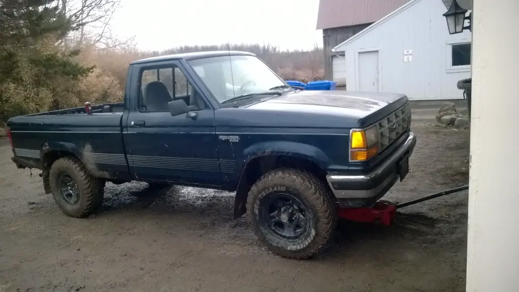

I bought it in the middle of winter in western NY, after I totaled my 02 Ranger fx4 in an ice storm. That truck had 32x11.5 tires on it that were almost brand new... within two weeks of owning the ST I had cranked the torsion bars and added Warrior shackles to make those tires fit. My truck didn't come with a tow hitch for some reason, so around the same time I installed a pro-series class III.
I tore out the resonator and tailpipe, and installed a 2.5" Jones Exhaust Max-Flow... basically a magnaflow clone, with a dump.
After a while I replaced the nasty worn out, 90's-era ford steering wheel with one from a 2004 ranger.
Also replaced the stupid aftermarket stereo the previous owner had poorly installed with the radio from the same 2004 ranger.
This is how the truck sat for about a year.

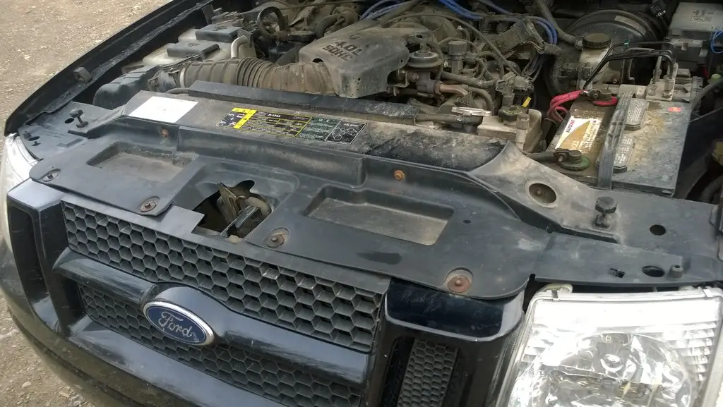

I added an led light bar behind the grille, wired to a factory fog light switch from a 2001 sport trac. Also installed a factory blaupunkt radio from a 2004 Focus SVT (?) ... then....

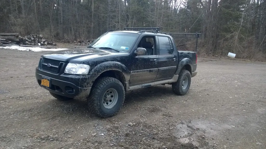

...then those 32's started looking too small, and I punctured one through the shoulder....
so a set of 33x12.50 BFG KO2's went on, with a custom 1.5" body lift.
Other small things have been swapped/replaced here and there.
And that's how the truck sits today. I figure at the end of the day I sit about 4-5" higher than stock. I'm happy with the proportions of it. From a distance, if you didn't know, I think my truck looks fairly stock. I have just enough clearance to clear the tires without funny gaps everywhere.
Full list of mods are:
torsion bars cranked
warrior shackles
33x12.5x15 BFGs on silver cragar 15x8 wheels
2004 Ranger steering wheel swap
2004 Focus Blaupunkt radio swap
2.5" Jones Max-Flow muffler and custom 3" tailpipe
Rancho rs5000 shocks all around
Poly sway-bar bushings all around
24" Led light bar behind grille
Clear corner lights
Led map, dome and cargo lights
US Rack Ladder rack
On the way is new leaf spring and rear sway bar link bushings, and someday steel bumpers.
She's getting there.
thanks fellas

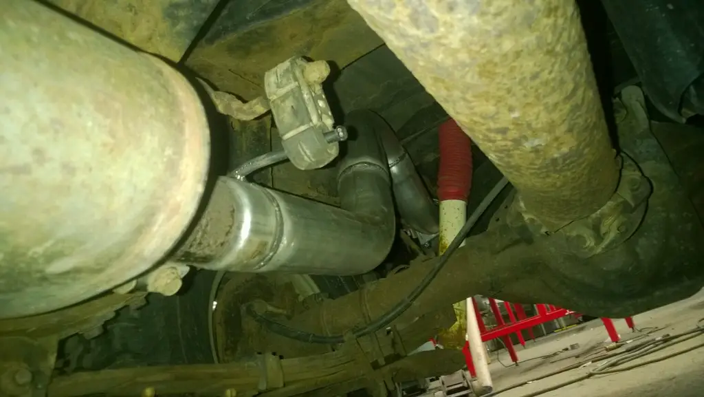

today I made a 3" tail pipe for the trac. I used the universal Flowmaster kit.
everyone seems to say that 3" exhaust tubing won't fit... it sure as hell does! sounds good... quieter in the cab, less drone, and deeper tone.
this brings my exhaust system to: 2.25" intermediate pipe, 2.5" max-flow muffler, 3" tail pipe.

the best I could do for a pic of the exhaust, for now... next time I drop my spare I'll get another.

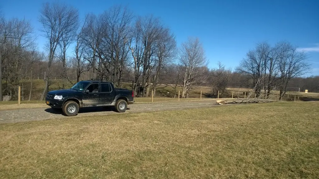

went out checking our seasonal roads today, pulled fallen a tree out and finally got some mud on the new ko2's!
after a couple of weeks with the 33's, I'm very pleased. the ko2's are quieter than the original ko's, and seem to do better in mud- they clear out gunk and stone better.
I was worried (not sure why, now) that the bigger tires would bog my ST way down and I would want to upgrade to 4.56 gears. in traffic and down the highway, I notice next to no difference in acceleration with the 33's vs. 32's.
is my truck fast? not really. was it ever? nah. it doesn't need to be.

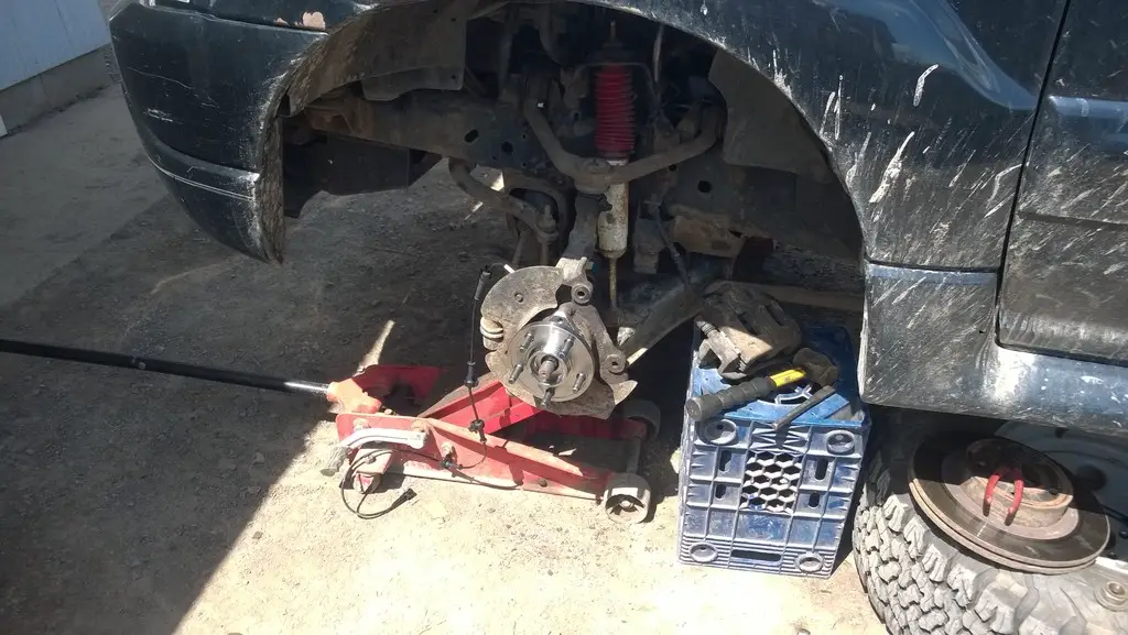

replaced both lower ball joints (with the new moog design) and my right CV shaft this past week. My outer boot had perforated and slung grease everywhere.
Interesting, my shop service manual says the lower ball joint is non-serviceable and the whole lower a arm needs to be replaced. eff that.
I was up to my elbows in nasty old grease trying to re-boot and re-grease my old CV shaft when I decided it was in no way worth it, $50 with a discount at my local Advance.

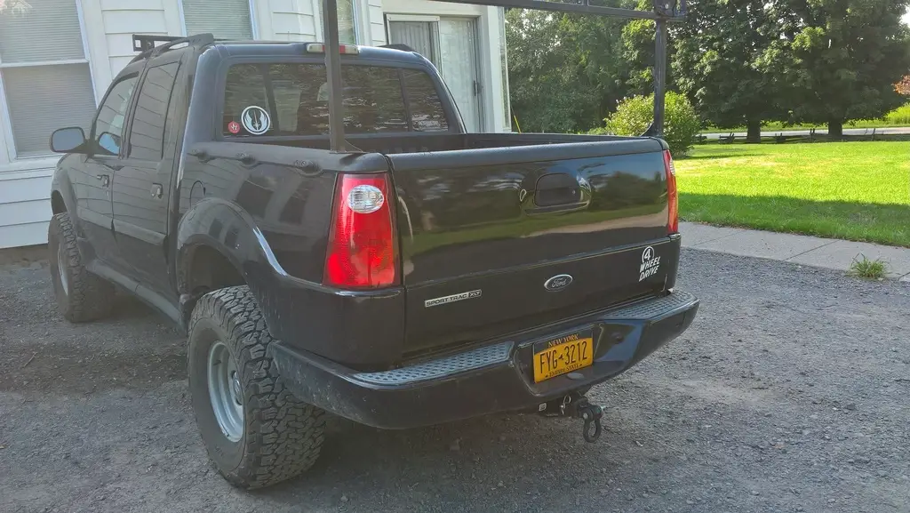

got my tailgate painted a couple weeks ago! No more junkyard truck look.
trac was having some trouble on cold starts in the morning. sputtering, crappy idle, would die on me sometimes, sometimes I could get it to rev a little and stabilize but it was a fight. no issues once warmed up and driving. SO i cleaned the MAF, IAC motor, throttle body, and air cleaner. Seems happier now.
truck turned 170K today as well!
If the cold starts come back and persists, keep in mind the shrunken intake manifold gaskets problem. I'm sure you are aware of that issue.
i thought the intake gasket issue was for job 1 and older motors?
Oh yes, you are correct. The 98-01's have that issue. In retrospect I see that you have a '04. My mistake.
