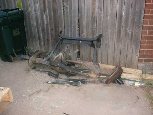

Here are Michael and I removing the Dana 44 from the 79 Bronco.

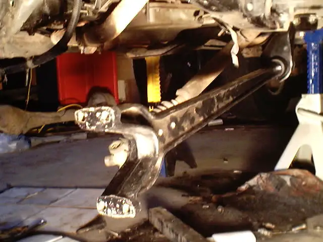

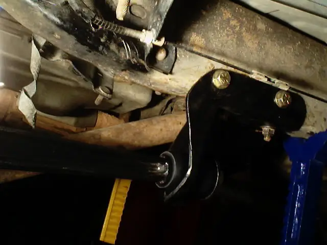

Good job. Are you staying with 15in. rims or are you going to 17s. That drivers side radius arm bracket looks massive.
I'm going with 15 inch rims. My reasons are for cheaper tires, cheaper rims, more tire availability, and more sidewall flex. Plus, the brakes fit in a 15" wheel, so why not.
The radius arm brackets are stock 78-79 full size Bronco hardware.

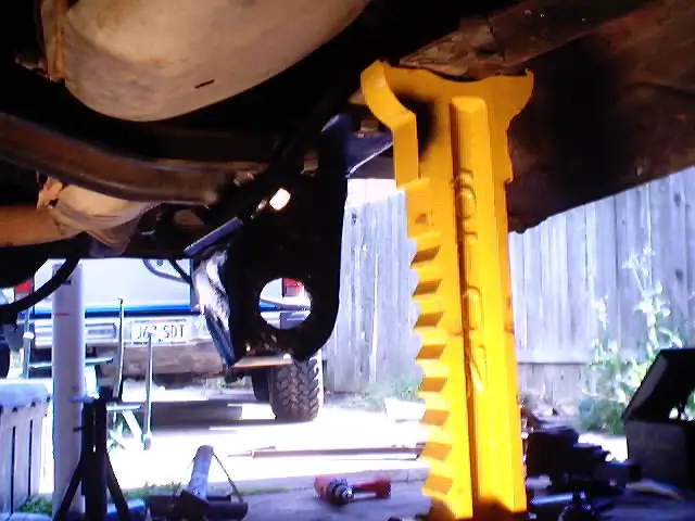

WOW!!! :eek: The truck has a radius arm.
That is a big improvement over dare I say it.... S.B. Truck...
