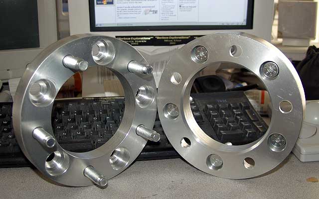

The wheel spacers I need for my front end came in today. After running my 35x15.50 Swampers for the first time at the Arizona run I noticed the tierod was rubbing on the inside of the tire. It chewed through the sidewall pretty good, but there seems to be enough meat left to continue using the tire.
To alleviate the problem I purchased a set of 1" billet aluminum spacers from Performance Wheel & Tire. They run $50ea. If you're interested their address is: http://www.performancewheel.com/

hrmm those do look beefy. and less expensive than the H&R ones. they have the studs already in em too.

I've got the H&Rs. I wish I had known about those before I bought the H&Rs, they are a lot less expensive but look as heavy duty and high quality as the H&Rs. I've been very satisfied with mine and think you will be pleased Rick.
(I wonder if all the people that always jump on those of us with spacers and tell us how dangerous they are and that they will wear out our bearings and give us dandruff and blah blah will tell you that too, LOL... I'll be keeping up with this thread :D )
PS: if your stock lug studs are the same as mine, you'll need to shave off about 1/4" off the length since they are very slightly longer than 1". A 3" cutting wheel works great.

Yep, my studs are just a bit too long and need to be trimmed. Adding wheel spacers is really no different than getting rims with a different offset.
wheel spacers seem to be some what of an urban legend. you always hear people say "i wouldnt use them, they brake and then your wheel comes off while going down interstate and kills a bus-load of nuns". but no one ever seems to know anyone that has had a failure with them. and im taking about a quality billit piece with studs, not some pieces of pot-metal that you can break with a good pair of pliers. looking forward to you wheelin' the snot out of 'em and proving all of the nay-sayers wrong.:D
A guy that uses my mechanic has had nothing but problems with wheel spacers. It's only cause he's dumb though :confused: He has a Vette with 1/4" spacers that slip over the studs. Problem is, the holes are way too big and the spacers vibrate, slowly sawing through the studs. He's had wheels fall off 3 times before, but continues using them. What a dumb@ss!

i am a big advocate of no wheel spacers.. i used to work i n a tire place and have seen the ill effects ...i would never use them on my car.... however, i believe that the ones rick got are good..as long as there is enough exposed thread after they are on and also they to will need to be torqued properly...rick is the kind of person who will actually monitor them not just set them and forget about it (like most idiots)... all it means to him is he will have 30 lugnuts to torque..and now he will have a problem solved...
