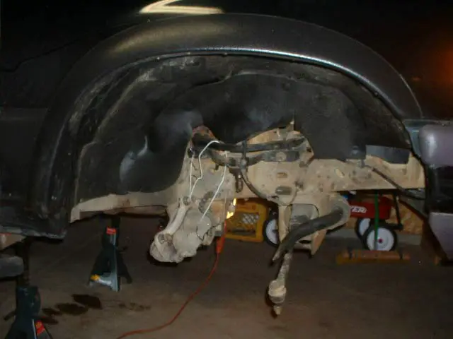

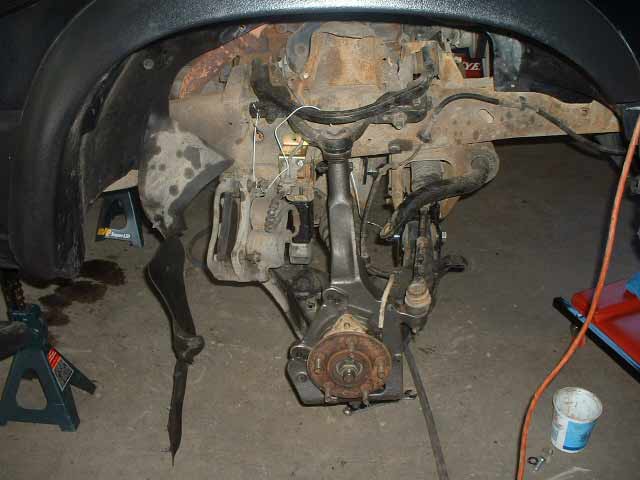

Well, today I started putting the Superlift 4" lift into Karol's truck. Took me about 2 to 2.5 hours to completely gut the front suspension and drivetrain. Here are a few pix :)
Here's the front left side gutted

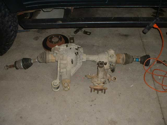

Front axle. Now I know why everyone hates the stock axle....It's lighter than the front axle in my Zuk fer cryin out loud!!!:eek: :eek:

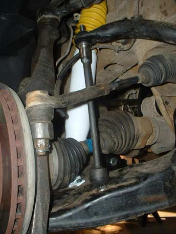

Here's the swaybar end link installed:

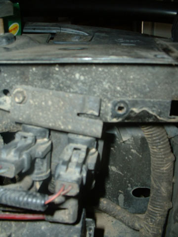

I had to relocate the vacuum control module for the front axle since the vacuum tubes weren't long enough to reach the new axle position. This is mounted on the right side of the radiator cross member. You can see in the shot that I only had to move it about 4" to the center of the truck.

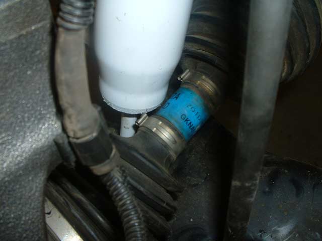

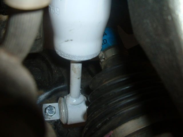

Now the problems. Here is the shock rubbing the axle.

Rub #2

Now, here's why the shocks rub. This is a pix of the stock shock and the Superlift shock. You can see that the stem on the stock shock is considerably longer, allowing for axle clearance.
