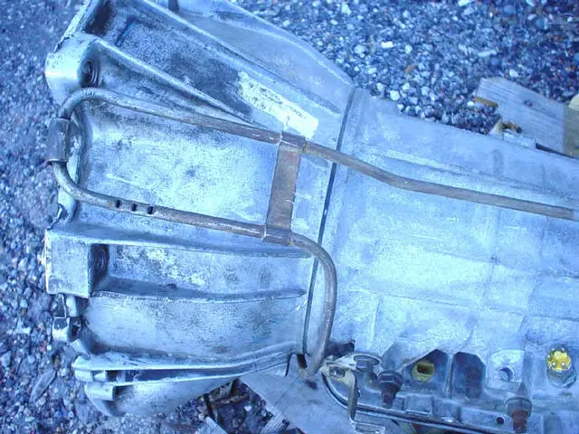

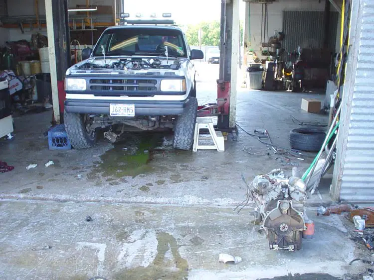

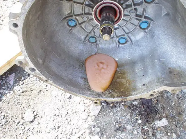

Well after going ahead and pulling the transmission and transfer case, my 30k mile "Ford" rebuilt transmission was completly full of water and transmission fluid, I don't even know how we kept on wheeling for another 5-6 hours after that.
So after further inspection, with the transmission out, I noticed 2 little rectangular holes in my vent tube up at the top of the bellhousing, I'm not sure what Ford was thinking but this turned out to be a disaster for me!
So after being pretty, well, miffed about that I went out back at work and snatched up a 5 speed and shoved it in there insted, so now I need to go buy a clutch and pressure plate, and swap out pedals, put the transfer case back on and put in the drive shafts, and we'll be back on the road, it just was a little more than my pocket book was ready to deal with this weekend.
So all you clowns with automatics that like to play in the water like I do, pull that factory vent tube off and replace it quickly, or you might wind up with pansyass pink fluid funfilling your day too!

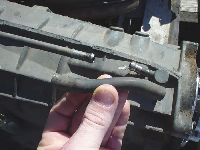

You may have to slit the rubber hose with a razor blade to get it off:
Then take your new hose and slip it over the vent hose nipple:
Once you have gotten your new hose on there secure it with a hose clamp or my favorite a zip tie!
Replace cossmember and appropriate nuts.

Here are a few pics of another transmission with the same delima:
