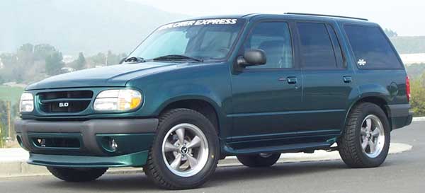

I am not positive that those Cobra Wheels will fit on a gen 2 X. They may fit on a 2WD ,but I am not sure about the AWD/4WD. The 18" Cobra Replica wheels we carry have a +24 offset and a 5 7/8" backspacing and they just clear. The Bullet Replica Wheels we carry only come in a 17" size.
By the way, we have the 285/50-18 Pirelli Scorpian Zero for $199.95 ea. plus shipping.
Here is a gen 2 Explorer with the 17" Bullet Replica Wheels.

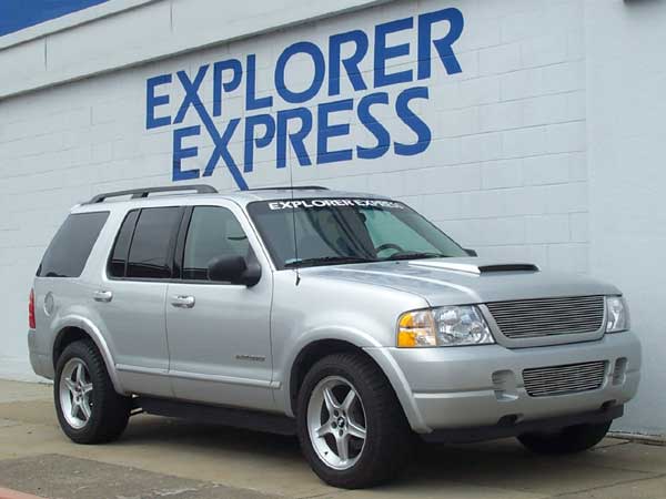

Here is a gen 3 with our 18" Cobra Replica Wheels and the 285/50-18" Pirelli Scorpians.

Hey John, is that the 35th anniversary Mustang scoop? Looks too short to be the 01+ GT hood. Was that hard to put on? What did it take?
Actually i havent gotten my truck back from the auto body shop yet but by the look of the wheel it will fit. There is about a 2.5 deep and a normal hub diameter for the front hub. If they wont fit then i'll run some spacers. I got them for CHEAP off ebay for $415 INCLUDING shipping.
The hood scoop on the Silver X is an aftermarket scoop that is similar to the 02-03 Mustang but has slightly different demensions. The scoops can be mounted with screws or 3M adhesive tape. I used the tape because I was not commited to drilling holes in the hood! The 3M tape holds STRONG, I am not worried about it coming off. They are avaible painted to match for $174.95 + shipping or in primer for $109.95.
