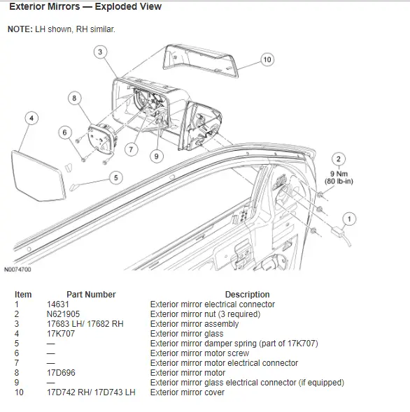

Hello I was just wondering if heated mirrors were plug and play for my truck its an 2007 XLT with heated windshield. I was going to replace the mirrors and saw on rockauto there were some that's heated so I figured that since I have heated windshield the wiring is already there?
