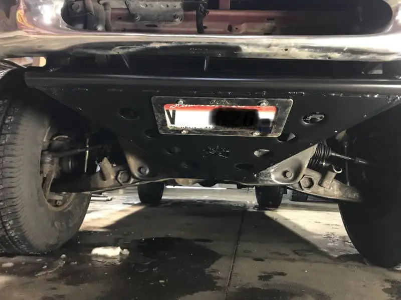

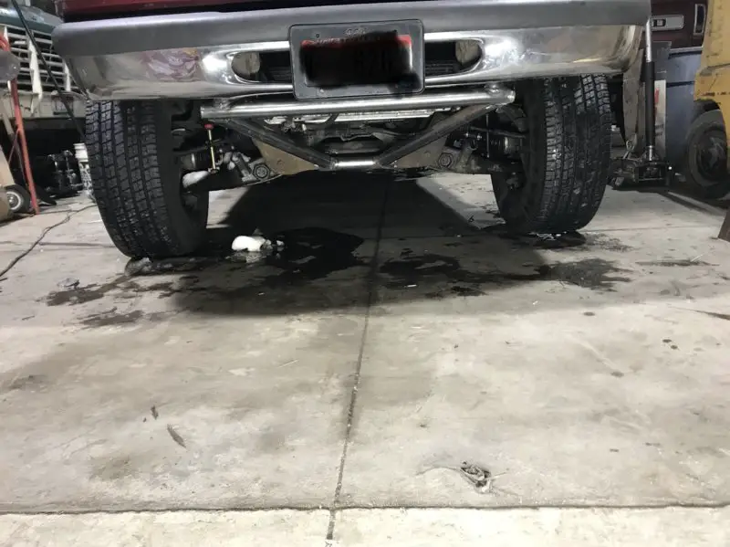

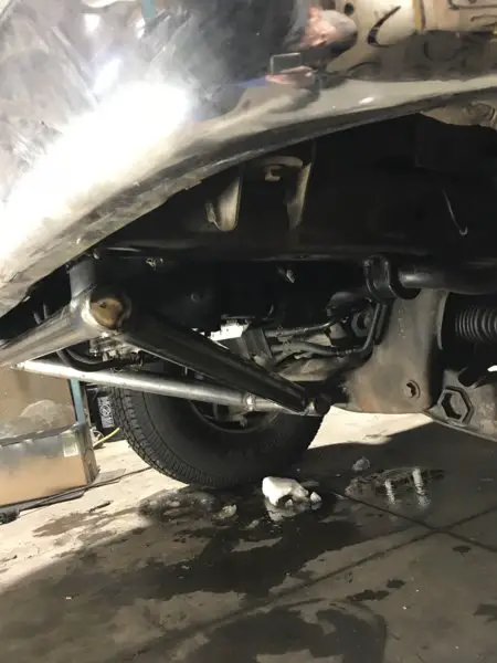

The front apron had been halfway torn off and screwed back on and the fog lights were burned out, so I removed all of that. But the radiator and trans cooler lines hung down below the frame rails quite a bit and looked pretty vulnerable. So I built a skid plate to protect all of it, and of course added dimpled speed holes and my shop logo.

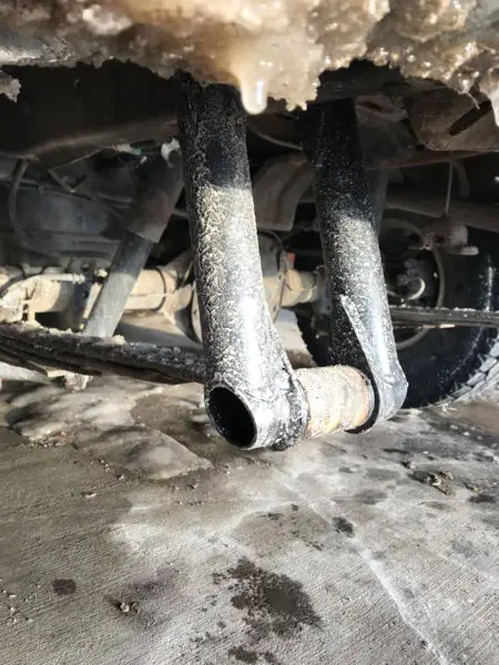

The bars got twisted for a 2” lift up front and I removed the rear sway bar and built some tube shackles for the rear lift. I watched for a couple weeks on CL for some 33” tires for it. I came across a set of 5 all-but-new Falkens mounted on some decent looking wheels. I did have to cut the twisted bumper and slightly trimmed the fenders to clear the tires.

Here’s a shot of the tube shackle installed.

I love the skidplate and shackles! Well done!

Thank you for the compliments on the skid and shackles. Those were fun projects.
