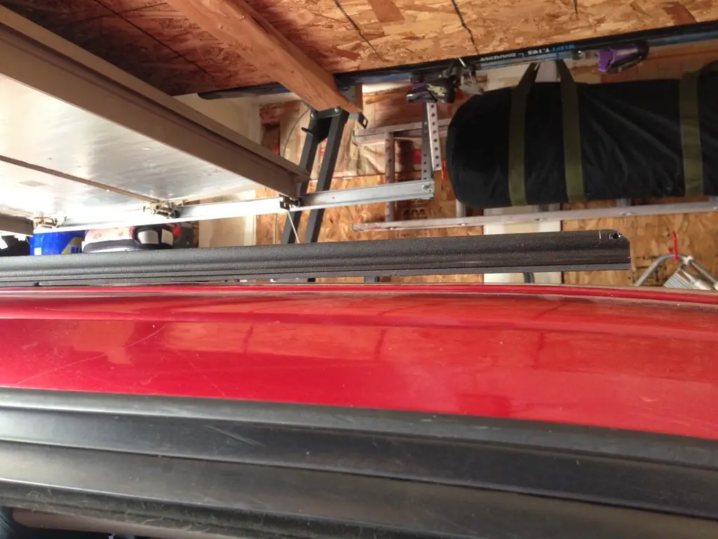

I recently removed my Eezi-Awn rack from my Explorer and put it on my Expedition. When I had the old Explorer rack leaning up against the fence with the old Expedition rack, it got my thinking: put the Expedition rack on the Explorer.

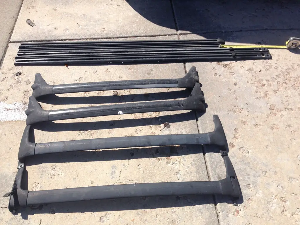

The Expedition cross rails are wider than the Explorer's:
But the Explorer cross rails fit the Expedition tracks!

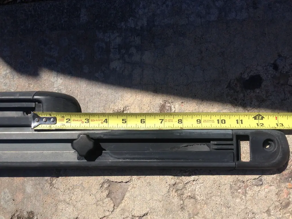

The Expedition tracks are 10.5" longer:

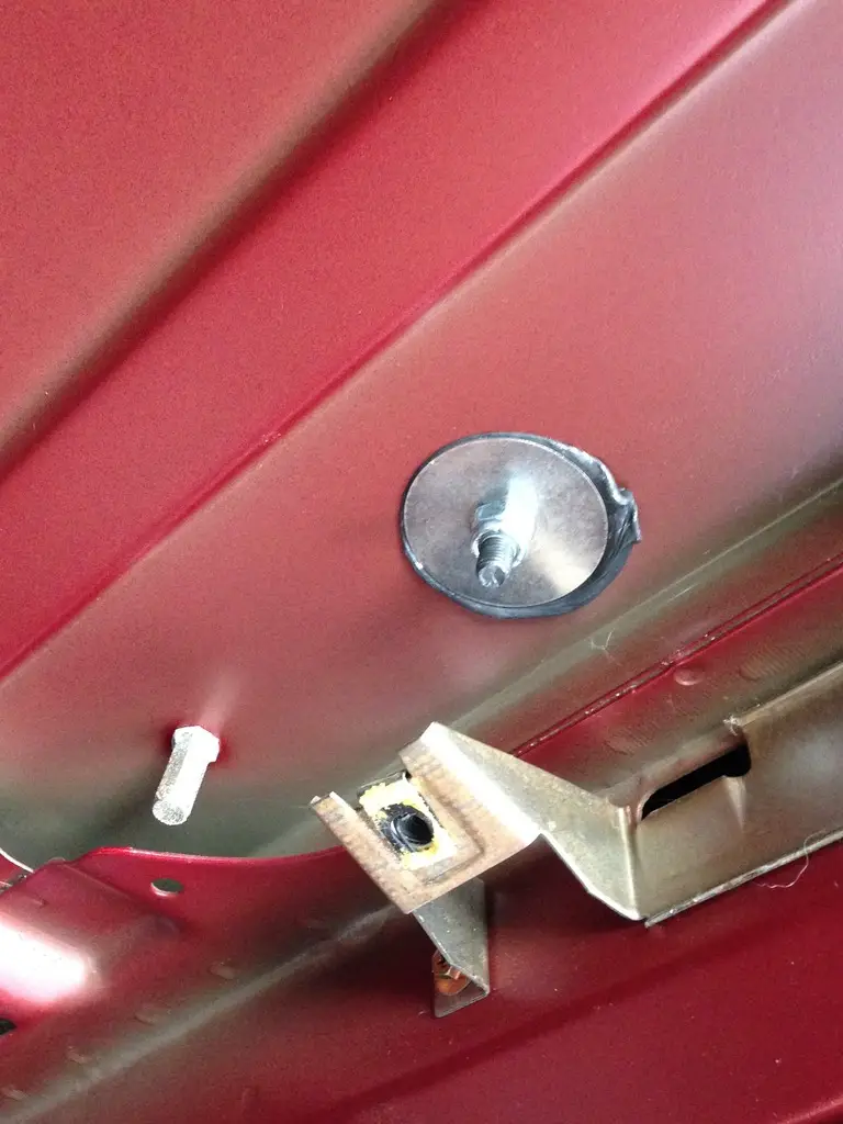

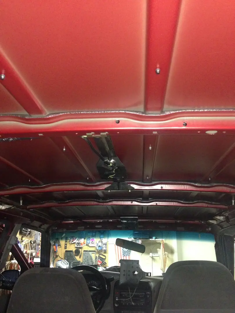

The Expedition tracks are held to the roof with 7 fasteners per side vs the Explorer's 5. But none of the holes line up- except for the rearmost on each side. So the headliner will have to be dropped so I can drill a bunch of holes in the roof to attach the Expedition tracks.
