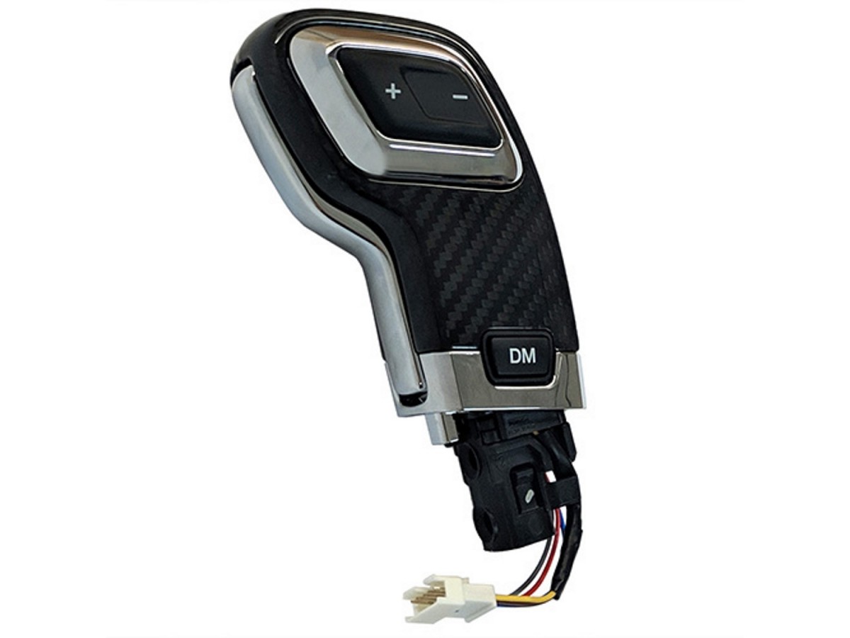

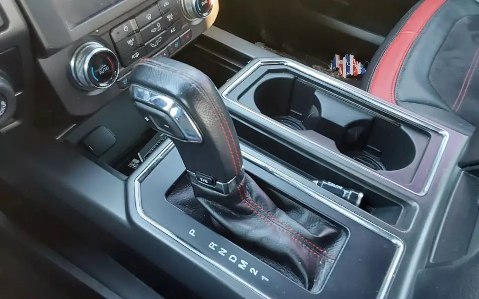

So do you need another project, I can predict this would cost you another $4k with all the many support items it needs? Here's the shift handle I expect to make fit my SUV;
F150 shifter Carbon Fiber option 2015-2020.jpg 2016 F150 shifter PRNDM21 pattern.jpg
View attachment 440253 View attachment 440254
$4k??? WOW.... lol. I will be taking on a new project with my El Camino SS... I need to begin work on that sometime soon, lol.
That shift handle looks pretty nice :D
