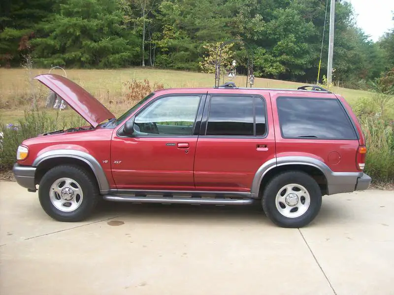

it's sad, but a lot of vehicles get ignored to death. people let these simple repairs mount up and then something more major happens and they don't think the vehicle is worth fixing. that's how I bought my highly optioned, 2000 XLT V8 for cheap. it had about 10 minor things that needed attention. I fixed most for free, or little money, and bought some used parts off eBay. I even had my local Ford dealer perform two recalls and a cruise control switch repair for free. It came with 4 brand new tires and a new battery. the only thing I can't get to work is the Mach radio display, otherwise it's 100%. My daughter and I have put over 5000 miles on it since I bought it last fall and it's turned out to be a rock-solid vehicle. it's not the prettiest Explorer/Mountaineer in my fleet (clear coat on roof peeling and some minor dents) but at 211,000 miles it doesn't leak a drop of anything and doesn't burn any oil.

well, it has the 6-CD changer and the factory amp/sub woofer, so the radio sounds great to me. as far as the display, I really only listen to one station anyway, and I installed an analog clock I bought at AZ for $7. good enough.
Oh, the door handle's not missing anymore and I even painted the new one to match. the PO had removed the rear one in order to fix the front one... makes no sense.
