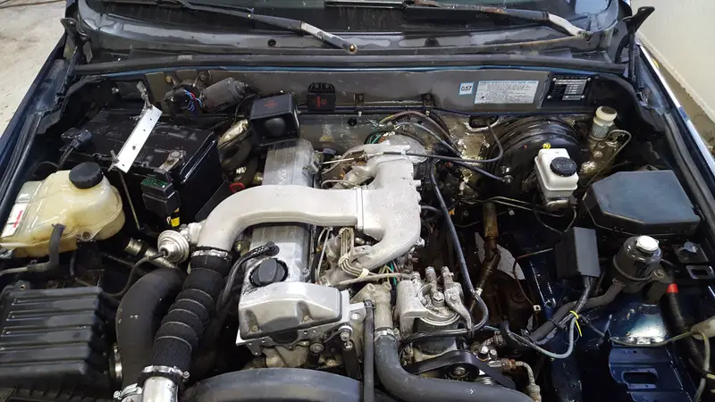

Top view of my engine bay
New battery,
new hydraulic brake booster and master cyl
new radiator
new steering pump
new steering assist jack
new alternator
what comes next...!?

Going to rebuild front suspension and make it diesel powered......

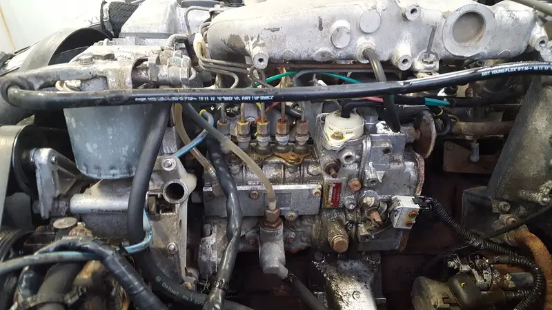

Cleaned everything with oil detergent... and looked at the connections for the engine, the electrical is childs play... just a glow plug relay and starter and alternator, oil pressure and thats it, the turnoff switch is vaacum operated even...
This is the noisemaker... inline fuel pump
I got it looking pretty clean, now I can remove it without looking like a coalmine worker doing it...
In a quick assumption this engine seems to be about 5cm (2 inches) shorter from edge of bellhousing to edge of fan blade than the Ford V6 engine... Which is great news and maked me inspired to keep the engine bay looking accessible...

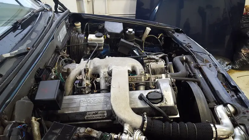

Engine:eek:ut
The ******* had to have a dual mass flywheel.... and ofcourse its old and worn and needs replacing, which means $$$ to be spent... :)
but the only thing to do is clean clean clean and think think think...... Tomorrow I will put the Explorer in and begin teardown...
Also there is a new nickname for the Explorer
EXPLUSSO..... (Combination of Ford Explorer and SSangYong Musso)
