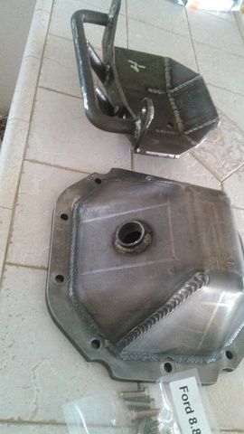

Parts are starting to arrive:

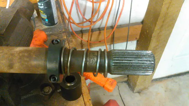

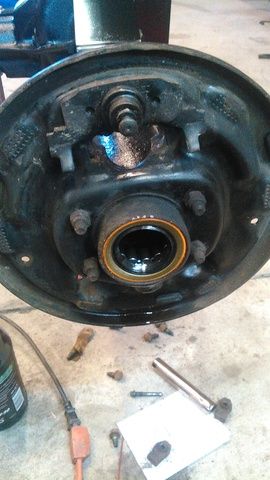

Out with the old, ready for the new:
Pressing ball joints out:
