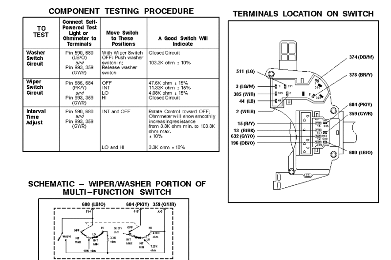

all the wiring diagrams I've found show a generic "box" with the wire colors noted... but this plug is in the shape of a "1" w/ 3 at the top (2 to the right a 1 to the left) and 5 at the bottom (3 at the very bottom and 2 just above them)… thinking I may have to go to the junk yard and buy the switch with the plug intact - with about 3-4 inches of wire??? "if" I can find one... I don't know what else - thank you, Thom
On Rock Auto it looks like your connector is the same part # as for this generation of Explorers.
I happened upon a (something, might've been a webpage or already a PDF) for an '03 Sport Trac that has a picture of the back of this connector on the last page. I'll attach it and do a screencap of the pic... not sure if it matches your Expedition wire colors but it beats nothing... maybe. :D
2nd pic has wire color initials on it
PDF the first pic came from (thanks Steve M!):
  • steering_column_wiring_repair_gen1.pdf
this is sooo close... got the actual pin numbers where it plugs in... in place of those generic numbers from Chilton... I guess my orange and their brown is one of the same - LOL...
THANK you J_C & thank Steve M! - this IS a very good start - do have a blessed weekend - Thom

THANK YOU!!! - the plug is the same for the 03 Sport Trac as well as '98 Expedition... colors are sooo close to the same - as mine has (3) to the right on the plug can't make out those numbers on the " terminal location on switch" and the colors don't match... but it is more than I had when I got out of bed this morning - thank you again, I very much appreciate it - 5 out of 8 aint bad... :)

The color photo that J_C provided is very close to my '98 Explorer, and hopefully to your Expedition as well, but the diagram, even though it has the correct circuit number seems a bit strange. Looking at wires in the color photo, I have a couple observations:
* The middle wire on the right is brown/yellow, not red/white
* The bottom wire on the right is light green/white (seems green in the photo)
* The top wire on the left is brown/yellow, not green/orange
* The bottom wire on the left is dark brown/white, not orange/blue
Hope that helps

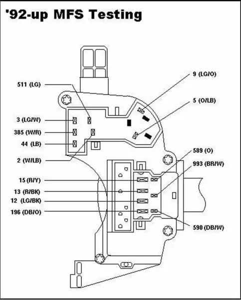

^ Yes the two pics are not consistent, and I don't know which one is right for a
'98 Expedition if either are, BUT I have now found a different diagram that better matches the first picture from the PDF because it has the LG/O and O/LB wires..
Did this job on my '98 Explorer a few months ago. This plug was used on several SUVs and trucks for a decade, and the wires pulling out is a very common problem. Should have been a recall, as this is clearly a manufacturing defect and safety related (happened to me in the middle of a long trip and I had to use hand signals, but at night they weren't noticed and it scared me to death).
Hope that helps
Thank you, but there seems to be some color differences in the '98 Explorer and '98 Expedition, there is no brown/yellow nor brown/white on the Expedition, must of been in a different shop - LOL, thanks anyway - do hope you have a great weekend. Thom
this is perfect, but I do have an extra terminal and wire. Between 9 & 5 - I have a terminal on my new and old switch and I do have an extra wire - the wire is pinkish/red with a black stipe, sooo - there isn't but one place for it to go... J_C - I do appreciate you and this forum... inspection goes out at the end of this month... PERFECT... :)
