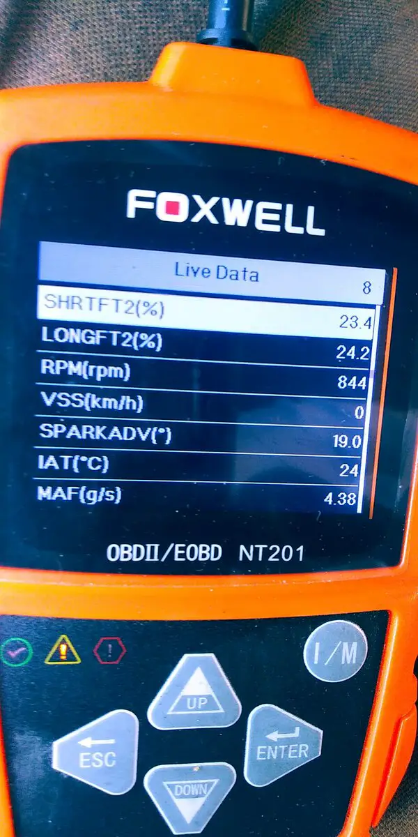

Here are some live data photos I took this morning.
That’s a lot more STFT than I’m used to seeing at idle. The other day, I think mine were single digits.
I disassembled the upper intake and discovered the o ring on the EGR tube was damaged but also discovered spark plug wire #5 was not connected! I replaced the o-ring on the EGR tube and popped the spark wire back onto the plug. Took it for a drive and all seems well, no codes appeared. Previously they was rattling under the truck which seems to have diminished though I can still hear it faintly. I attached a photo of the live data while it was idling. Do these numbers appear right?
I got one! yippee ! ...that was your revving idle/vacuum leak and dying .... 5 cylinder not great either :)
Rattling is probably a bent heat shield or poor exhaust hanger ....it was magnified by rough idling engine.
23ST and 24LT is 47 positive total trim. A CEL is on the way. A repair would make the numbers trend down(e.g. STFT negative). Unless the scanner isn't reading right.
The truck will remember ltft when you start and stft will be negative if things get better.
Eventually ltft will "learn" stfts correction.
They should in a perfect world be zero, but 0-5 range is optimal too.
A lean code usually means insufficient fuel, but it could imply too much air. The computer monitors the incoming system air flow through the mass airflow sensor and adjusts fuel flow accordingly.
But if you have a vacuum leak then more unaccountable air is getting in the system.
