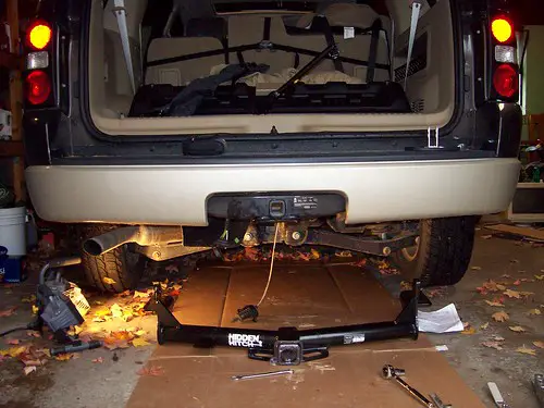

I decided to add a class 3 hitch to my 07 EB. The stock class 2 hitch is too high to tow my snowmobile trailer and I couldn't find a drop bar with enough drop. Plus there are a lot more options with a class 3 hitch.
I decided on a Hidden hitch ordered from www.ontheball.com. Delivered it was $167.88 and it came in about 3 days.
I'd seen other people post here how easy it is to install so I figured I'd give it a go.
First I removed the spare tire and staged the hitch.
I put the plates in the frame for the front bolts.
I attached the bolts to the pull wires and pulled them through. You really don't need the pull wires for the front bolts but it helps to keep them in place when lifting the hitch in place.
Pulling a front bolt through its plate before lifting the hitch into place.
I lifted the hitch into place with a floor jack and hand tightened the nuts. The biggest mistake I made was when removing the pull wires from the front bolts I wasn't very careful and damaged the part that threads on to the bolt.
The pull wires are critical for pulling the rear bolts into place. To get the rear bolt and plate into place you have to feed the pull wire into the rear bolt hole through the frame and out the same frame slot used to put the front bolt in. (I forgot to take pictures of this part of the operation.)
Rear bolt hole.
You have to put the backer plate and bolt into the frame separately but even with my damaged pull wire they still came together and I got them out the frame hole.
Completed installation.
If anybody is interested in this and would like some advise or more pictures I'd be glad to do what I can.
Thanks for reading.
