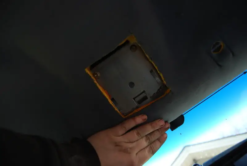

So I guess the biggest question is do ALL xploders have the tabs to mount up the overhead console?
I've noticed that Xeek and Foxracin have installed them.
I was asking the "stupid" question before I cut my headliner... if there isn't tabs to install (as per the link that was provided) how would I go about this?
It's raining today in TN so the odds of me doing this today are prob slim to none.... plus I only want to mess with wiring once(awaiting emailed schematics).
it is my understanding only 94 limiteds had them stock.
i grabbed mine from one at the junkyard, and ripped out the wires all the way to the plug behind the dash.
im pretty sure foxracin didnt install one. but i know red.eddie4x4 did.
both of us had to cut holes for it
that is a pic of the mounting plate already screwed on. do you need those two holes to get this far.
for the rest, i didnt take pics but the two vertical slots on the plate, you need to drill out your roof for those slots. if you look at the console itself it has tabs that need to be pushed in, and they wont go in without making those slots in your roof also.
the only thing i didnt do is cut a hole for the tab in the middle. it took some banging with my fist to get the console to lock into those side tabs since i didnt cut a slot for the middle on into the roof.
as far as the holes that screw through the headliner up above. mount the console into its tabs, peel back the sunglass holder and stick the screws in the holes and just take a screwdriver and tap them in. mine found the holes in the mounting bracket perfectly by doing that.
i think i cut away more headliner up top also. i want to say it wasnt fitting right if i didnt. not sure if that pic was before or after i cut more
overall it works. extra light when the doors open. i have it wired to my fan controller and for some reason its dim if the trucks running. its 100% when the trucks off. and it likes to stay at 5C(even tho its set to F) or SC now. when i shut the truck off and wait a few seconds itll display the temp.
i think thats just a bad sensor
Cutting the headliner I'm not worried about, I was asking if the mount tabs were already there so I could mount the bracket.
Xeek if I understand you correctly, the tabs are present and you have to pre drill the tabs in order to mount the OHC bracket... is this correct?
If it is the case, this makes me feel better since you have a 91.
The limited I pulled the harness from I had to cut the wires from the main harness... you mentioned a plug. The only plugs I got were for the auto dim mirror, console, and map lights for the visors.
no. your roof has nothing. the console mounting bracket has 4 holes and 2 vertical slots on each side. then theres a tab on the bottom that kinda locks it into the roof. i didnt cut a slot for that tab. i did cut for the 2 slots on the sides and the 2 holes for the screws
