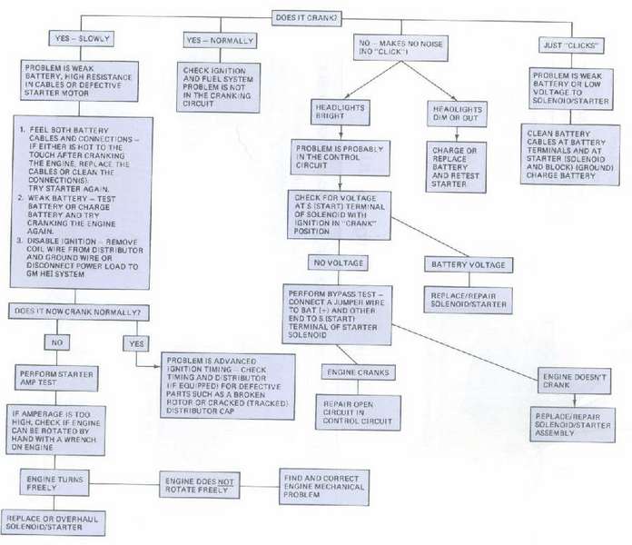

Slow Crank/No crank - Refer to Amperage Testing section and diagram at the bottom

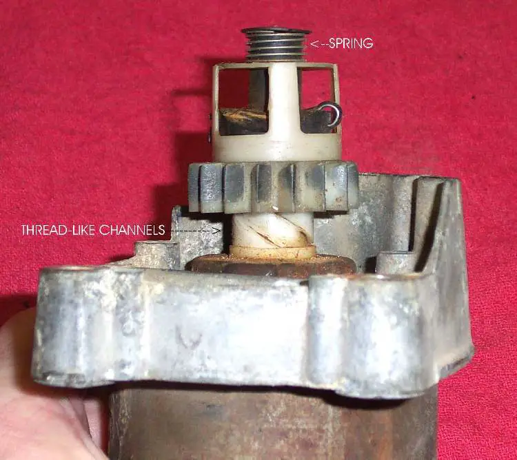

Most modern cranking circuits include a Starter Motor (an electric motor that can develop nearly 8 horsepower for a very short time when first cranking a cold engine), a Battery (must be at least 75% charged to make the cranking circuit work properly), a Starter Solenoid or Relay (turns the starter on and off), Starter Drive (inside the motor, made up of a shaft and pinon gear on the end which engages into the engine flywheel and rotates the engine), and Ignition Switch (controls the starter motor operations)
Everyone Loves Pictures:
Starter Drive (w/ Pinion Gear):
Ignition Switch:
Starter Solenoid:

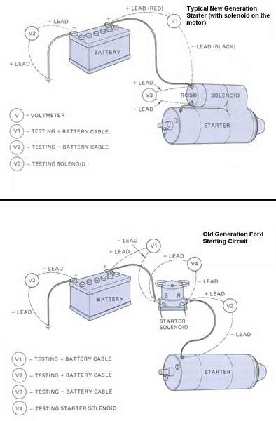

Voltage-Drop Testing
Voltage drop is the drop in voltage that occurs when current is flowing through a resistance. If voltage drop is too high, which can be caused by dirty battery terminals, might inhibit the ability of the starter and not allow it to operate.
Step 1:
Connect the positive voltmeter test lead to the most-positive end of the cable being tested. The most-positive end of a cable is the end closest to the positive terminal of the battery.
Step 2:
Connect the negative lead to the other end of the cable being tested. With no current flowing through the cable, the voltmeter should read zero because both ends of the cable have the same voltage.
Step 3:
Crank the engine. The voltmeter should read less than .2 volts
Step 4:
Evaluate the results. If the voltmeter reads zero, the cable being tested has no resistance and is good. If the voltmeter reads higher than specified, then the cable should be replaced. But, before replacing, check connects of the cable to make sure they are clean and tight.
TIP: If a cable is hot to the touch, there is electrical resistance in the cable. Touch the battery cables and while cranking feel for heat. If any cable is hot to the touch, it should be replaced or cleaned.
Also, you can test right across the battery. You should have around 12.6 volts for a fully charged battery and when the starter is energized, it should cause the voltage to drop down to about 9-10 volts.
Voltage Drop Testing Diagram:
