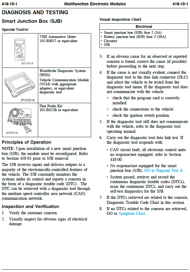

iI am planning to replace my dash harness with an 08 explorer that came equipped with sync and dual a/c. Also I have to replace the smart junction box. I am going to be buying the sjb from the same salvage vehicle.
My question is once I remove the original sjb from the vehicle does it reset and do I have to take my car to dealership to get it reprogrammed?
