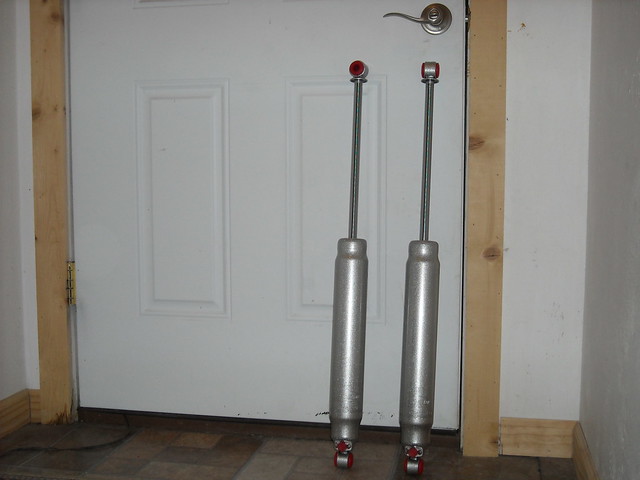

Hey guys,
Finished up installing the F250 Towers a few days ago - been doing some reading and decided to go with some Rancho 9000 series shocks. However, I still am trying to make sure I go with the correct model in terms of compressed/ extended length. I am currently building a 1993 EB with Stage II 5.5" Skyjacker kit, coils broken in but with rubber insulator pucks that are going to bring these soft(ish) coils back to stock height. 4X50 Seems to have bough the Rancho 999028 for his ride - Can anybody confirm these as to be the best option in length/ travel for a 6" Suspension lift?
I should be able to get most of the front end reassembled tomorrow, so worst case scenario I'll have to take some measurements and follow up to help anyone out with a similar question.
