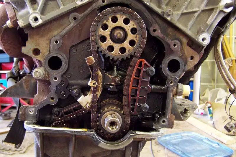

Currently, I have all plugs pulled from the last compression check which lead to finding a loose follower laying on the head. Come hell or high water,
I will get that follower back in place tonight. Question:
I have no access to an air compressor so I just filled the cylinder with rope. Also, I have the intake system still off. How do I go about building compression for another compression check? Will putting the valve cover back on and turning the motor over several/a few times do it? Appreciate any guidance. Thanks! -DW
