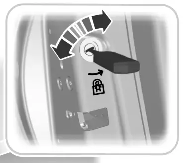

2 The passenger side rear door will not open from the inside. (It's not a former Police vehicle). There are no child safety locks that I can find and the drivers side works fine. How difficult is it to pull the panel and what am I looking for once I pull it?
