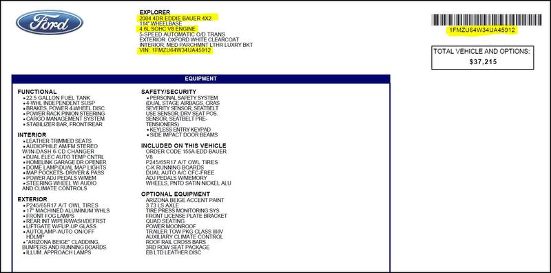

I am in need of a very quick huge hand guys. I have successfully swapped a ported and polished 4.6 in to my 4.0 EX. Everything works as it should ( I'll update the other thread shortly) except that I did not take in to consideration the IVD system... I need some one with a 2003 or higher Explorer with 2WD and a NON IVD (traction control, stability control) set up. Your vin number is all I need. It is the only way the geniuses at Ford know how to find parts, and the guys on e-Bay don't know what they are selling.
The truck is drivable, sounds mean as hell with new exhaust, and the engine wants to take off. Unfortunately since the PCM does not see the sensors for the IVD it eases the throttle. It is the last thing that I need to fix before it is !))% normal functioning.

This might help...
Or this 04, 4x2 with a 4.6...
Thanks a bunch. I should have posted earlier just got busy with chores this weekend. I found one that worked off of Craigslist. The truck is now done and running properly!
I can't thank you guys enough for the help. It means a lot.
