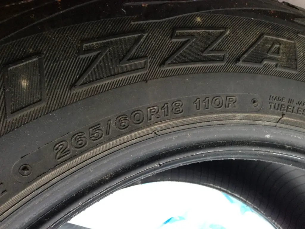

Sean, I'm assuming your Sport has the 255/50R20 size right now. If so the 265/60R18 will have a diameter variance of 1.60% which is well within the accepted maximum 3% variance.
Much thanks for the quick replies, recommendations, and excellent pics! :)

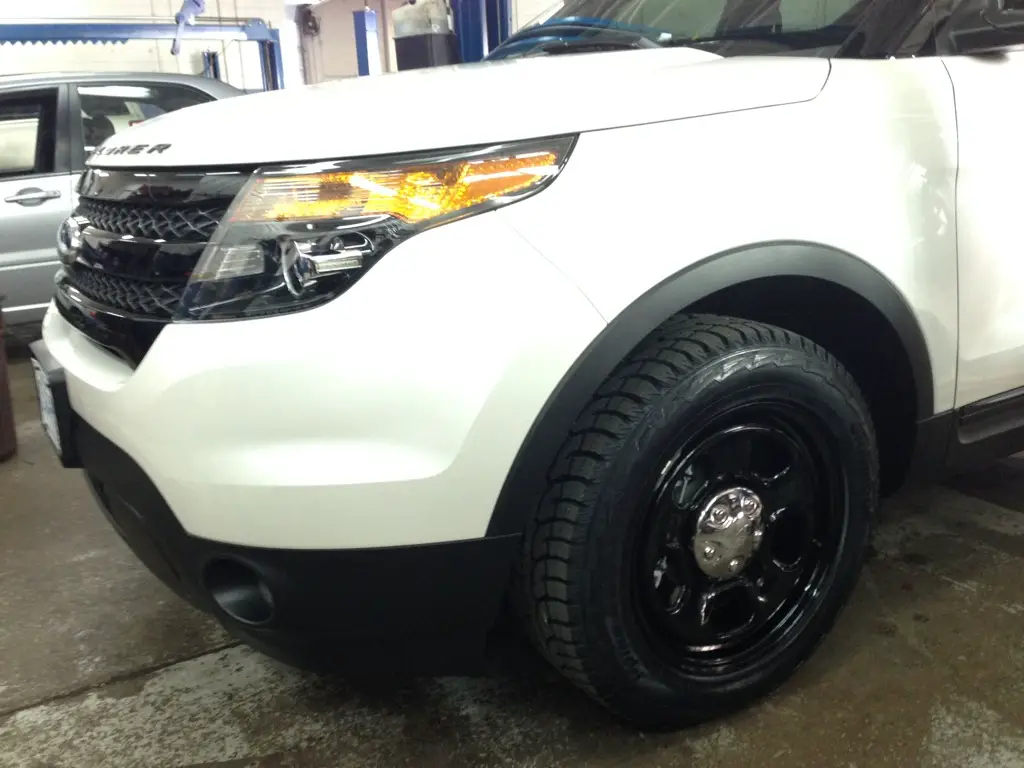

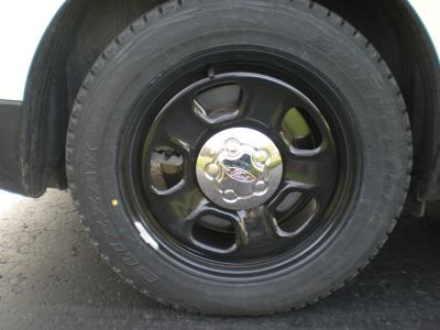

I currently have the OE stock tires and wheels. A Ford dealership recommend "Interceptor" 18" steel wheels @ about $120 each. What would you recommend?

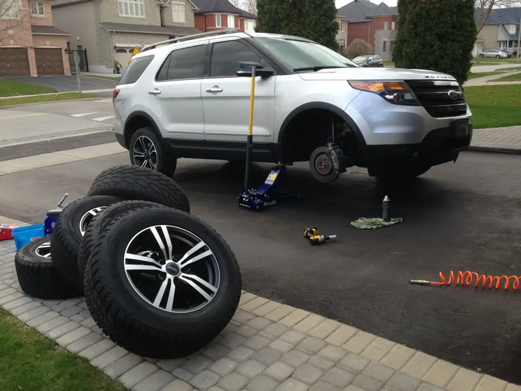

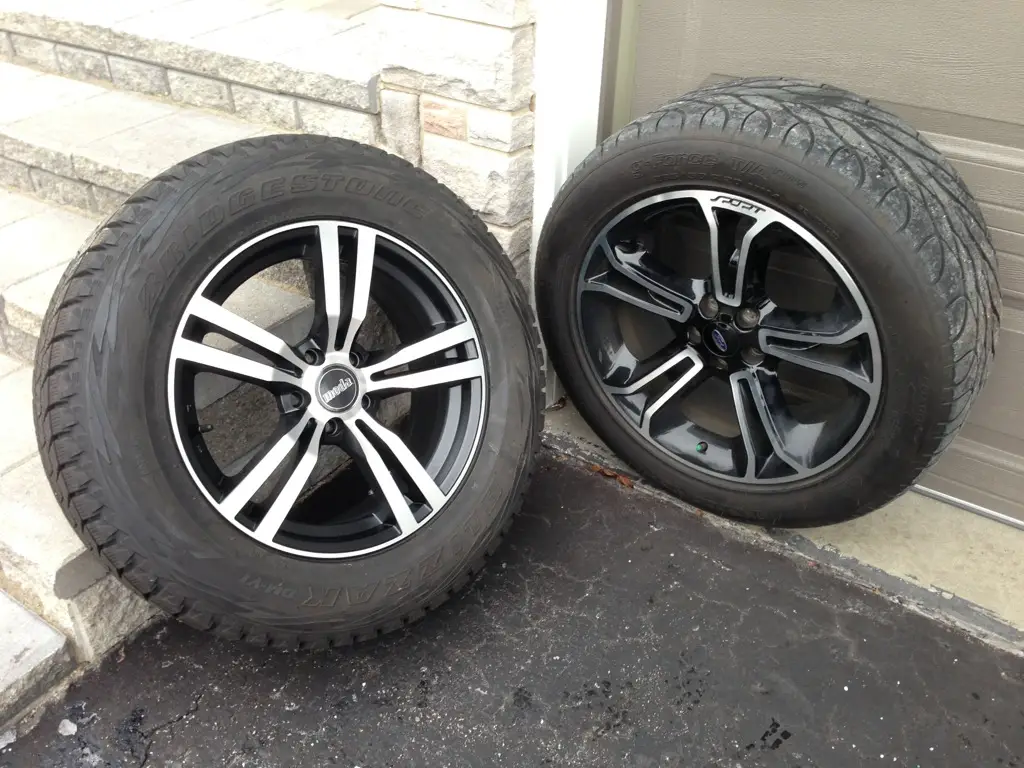

The Interceptor wheel (think the Interceptor Wheel is a 17" not 18") is a good fit but it looks like a crap steel wheel, which it is and if your Explorer is Black or White they will make it look like a Cop Wagon. If you do go with that wheel get the Chrome Ford Caps and they'll look a bit better but, remember they will rust immediately and really start to look like crap after a season.

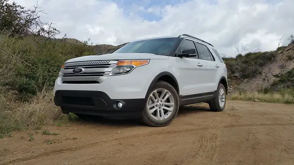

I went with a Moda from Tire Rack, there's a few different options and TireRack have a tool to see how the tire will look on your car.
What kind of tires are those? They have a tread design similar to my Cooper Weather Master

I currently have the OE stock tires and wheels. A Ford dealership recommend "Interceptor" 18" steel wheels @ about $120 each. What wouldyou recommend?

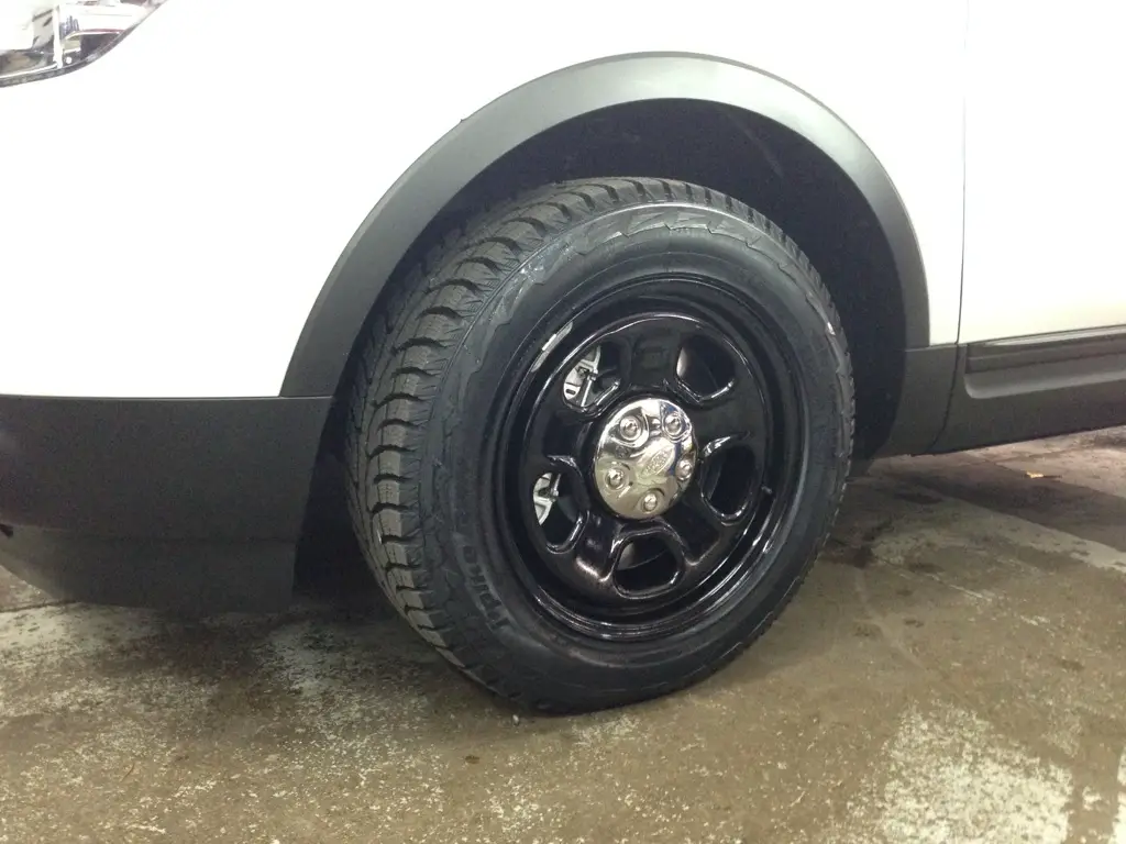

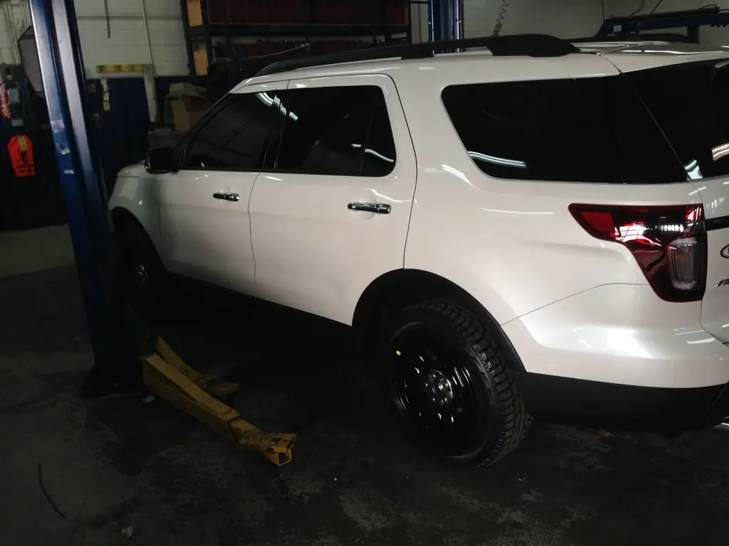

I have the Interceptor 18" wheels that I use for Winter tires. Dealer listed at $102.95 each and charged me $88 each. They charged me $20 for each wheel cover.
That's all they're worth...
LOL
The look is abysmal, IMO.
That said, the set up is thoroughly functional.
Thanks again "TheMustangShow". The pics are very helpful and I will check out Tire Rack. :)
Thanks for the quick reply, pic, and confirmation on the price Peter. :)
