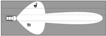

This gadget allows the low beam lights to be illuminated at the same time as the high beams thus utilizing 100% of the trucks light capability.

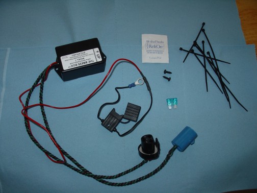

I ordered the Brite Box directly from the manufacturer. Since my ’99 Explorer uses 9007 headlights, I required model number 7; other light configurations require different models.
Upon examining the Brite Box, which measures 3 ¾’ x 2’, it soon became apparent that this is an extremely well built device using high quality wiring fixtures.

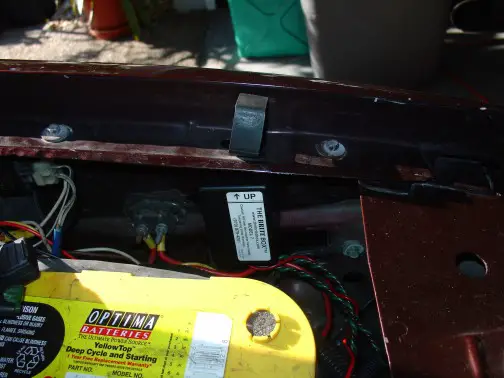

The first step in the installation was to disconnect the battery’s negative terminal. Then remove the 20 amp fuse from the fuse holder that is attached to the Brite Box. This was followed by unplugging the connector to the driver’s side headlight ( in view of the fact that it’s closest to the battery ) and plugging it into the receptacle on the bright box. At this time the plug from the Brite Box was inserted into the headlight. The fused lead from the bright box was then connected to the battery’s positive terminal.
To draw the installation to a close, the Brite Box was mounted with the wires exiting from the bottom by attaching to the inner fender behind the battery with double sided tape ( after thoroughly cleaning the surface with acetone and then the wiring secured with wire ties. That’s all there is to the installation.
