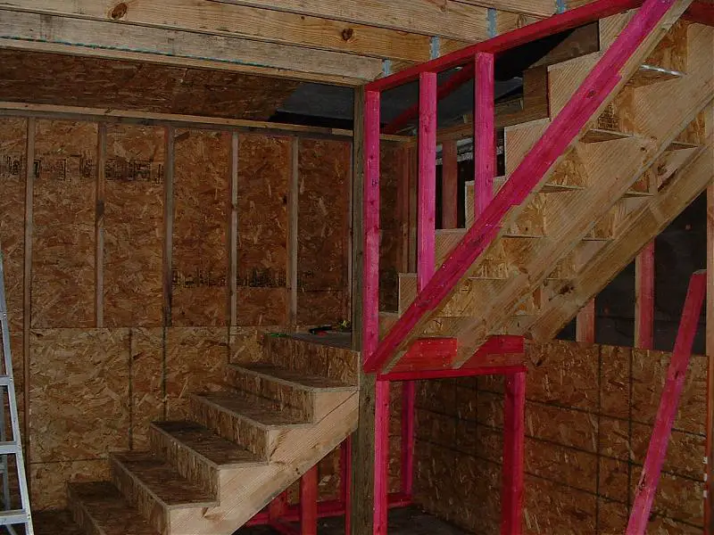

So here is the house project and where I'm at. As you can see I have a BUNCH of work to do. The stairs lead up to the second level where there's not even walls yet. I'm looking at a 18' by 30' space that I need to wall in and dry in as soon as possible. Once I get dried in, I can take a break. I'm doing all the work myself so that's why it's taking so long. Trying to hold down a fulltime job, take care of teenage boys and a young daughter, and make the wife happy is keeping me busy. I look forward to when I can get back on the explorer.
