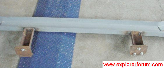

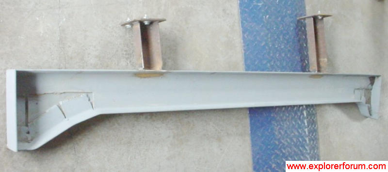

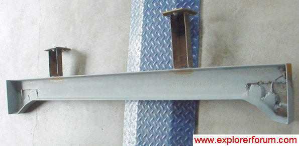

Originally posted by tiessen
1. You will need to 'close in' the bottom of those rails, or rocks, etc will get caught up in them.
2. 2 frame mounts will definitely not be enough.
Originally posted by 410Fortune
I have seen people repetedly try to make sliders that only attach at the frame only to find out later that it just doesnt work, I mean they work but without the additional support of tapping into the body seam, they will bend, break, or even worse rip the frame.
So yes they may hold the truck up when you put a jack under them but for hardcore wheeling they usually bend....of course if you dont do hard core wheeling like some of these nutty fella's out here who cares right?
Just keep us posted how well they hold up.....
I'm sure some will, but 2 is all ya can get away with em, but when mine are made, I'm sure im gonna have 3 frame mounts...Originally posted by 410Fortune
410fortune I have seen people repetedly try to make sliders that only attach at the frame only to find out later that it just doesnt work, I mean they work but without the additional support of tapping into the body seam, they will bend, break, or even worse rip the frame.
i am building my frame sliders and was only doing frame mounts , where else should i tie them in at any help would be appriciated......and any pics would be appriciated
