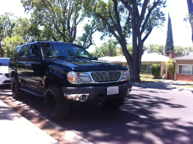

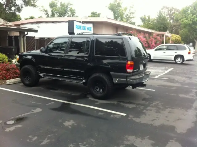

I lifted my 99 4.0 4x4 with and extra leaf and raising up the keys in the torsion bars. I was able to fit 31" BFGs very nicely.
How cheap are you going to be?
Torsion keys can be had for around $50 from ebay, and the ProComp long Add A Leaf was a little over $100.
That will give you an easy 2" up front and about 1 1/2" in the back.
Warriors are just shy of $100, then you'll have close to 3" in the back.
If you go 2" in the front you should get the longer shocks. I think retail is about $60 each. If you have Advance Auto Parts nearby you canbuy online and put TRT30 in the discount code and get 30 percent off.
I just did mine over Memorial Day weekend.
