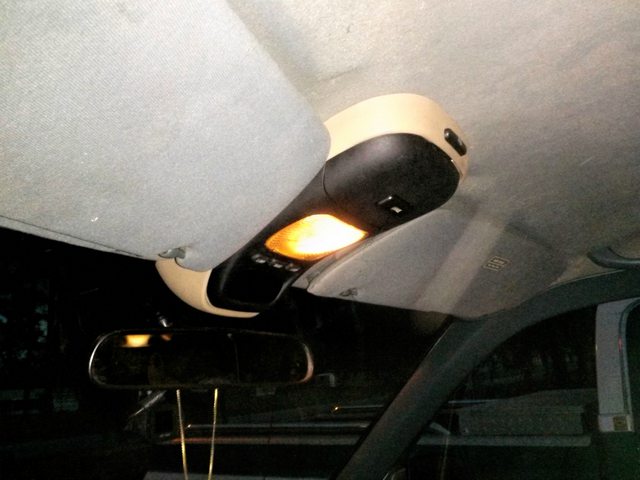

I was at the junkyard and found a second gen. Explorer with what looks to be show room, off the lot clean interior, like it was never even breathed on. I took the overhead console, and RAPS module ( my Mountaineer's was missing ), and I'm going back Saturday to get some other misc. interior parts, probably the full length center console.
Anyway, I figured I'd just post here showing what I had done for the day, I wired up the map lights, and dome light. Tomorrow I'm going to install the ambient temperature sensor, and hook up the thermometer/compass.
I'm going to get some color-coded willow green interior paint and paint it green, or just keep the tan, because in person the tan on green does not look that bad.
The structure behind the headliner already had the cut-outs for the clips, and holes drilled for the mounting screws, all I actually had to do was cut out a section of the headliner, and run some wiring to my dome light, and visor mirror lamps.

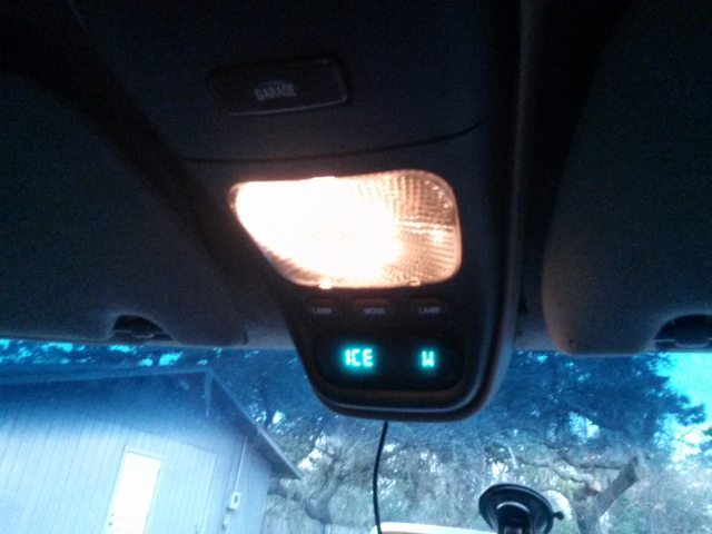

I'm having trouble with the overhead console, I'm pretty sure it's just a bad temperature sensor, because i'm 100% sure I put all the wires in the right place ( Really good at electrical ), but my overhead console is reading ICE -40f, and doesn't change at all. I calibrated the compass and it works fine, but I want the temperature to work as its the main reason I wanted to do this install ( other than being bored and having fun with electrical )...Any ideas?

did you put in a new temp sensor?
in my 95, i think its only used for the console and located front under the radiator - in that area
mine is off a few degrees and i need to change it out - or clean it maybe
Not yet, going to grab a new temperature sensor tomorrow.
You hooked up the wires backwards and then fried the sensor.
They have to be hooked up correctly the first time, or good bye sensor.
-40 is it's default to 'fail' mode.
I saw mine at -30 in reality before. :(
But I didn't, I spliced the Blue/Yellow to Blue/Yellow, and Blue/White to Blue/White.

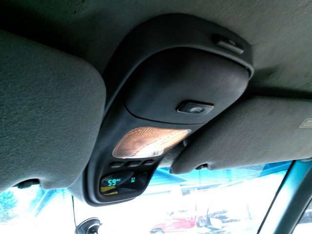

I found an Explorer with Willow Green interior today!! Took the Willow Green overhead console, two temp. sensors, a new auto-dimming mirror, and some small little parts my interior was missing, I'm like a kid in a candy store!

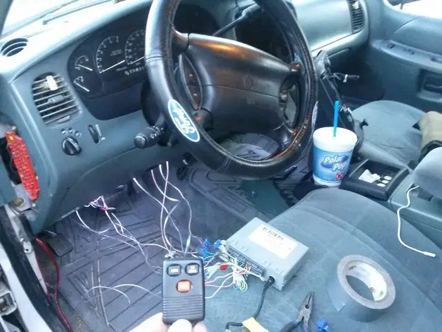

Your post convinced me not to do the RAP module, but today I was really bored and decided to give it a go. I chose to place the RAP module under the dashboard near the fuse panel, so that the wires didn't have to be ran all the way to the back of the vehicle, used less than half the wiring I would if I put it in the original spot. I just used wire clamps, and tapped all the wires into the vehicles wiring harness under the dash.
End result, works great!
Yeah, it's not too bad on pre 97 since there's not chip keys. After 97, you have to deal with all that fun stuff.

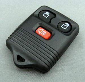

That fob looks out dated though, I think you grabbed an old one.
Yeah, I grabbed it simply because the fob happened to be in the ignition of the explorer I got the RAP out of. What's the newer one look like?
Any Ford from like 95-2008, lol.
