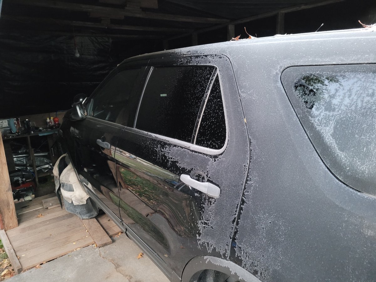

I believe your right. To entertain this idea though, I've taken a photo of the vehicle half-assed inside with the rear sticking out lol, because I discovered an interesting phenomenon.. You'll see the frost exposed on the rear end of the vehicle in the photo, that is exposed to more air flow and the elements. This Photo was taken a few days ago around +21°, according to phone weather report, +16° on the Thermometer, and it's only October, wtf.
My vehicle is currently under a half cover, (3 walls & roof, rear towards the open end) I would assume, in winter time, that because the engine is under full cover it wont be exposed to as much warm air such as from sunlight, compared to the wide open, though being exposed to snow and a wind chill would exaccerabate the temperature, actually the engine may be warmer in this particular case.

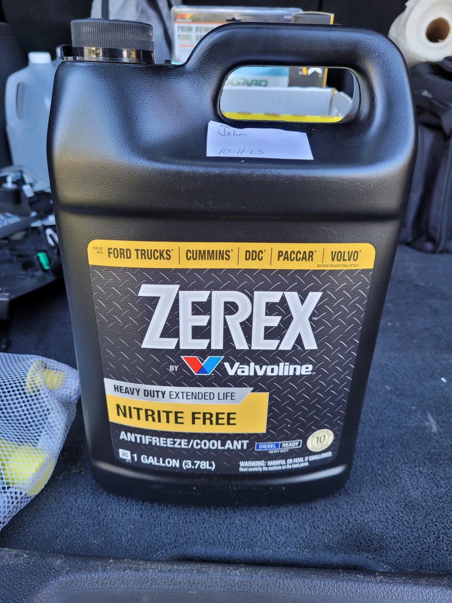

Though despite my preferences, the important thing next to having any type of coolant in the engine, is compatibility; The chemicals that come into contact with the Seals and mixing with some of the old Coolant, whether that's going to diminish the Seals faster or be perfectly fine for this particular engine.
After doing one engine flush with distilled water I can see much of the orange coolant still in the system, so multiple flushes (Super Flush), will be necessary for the full benefits.. or quick seal deterioration, hopefully someone has experienced this change over so we can find out if it's a mistake or not, for this particular engine)

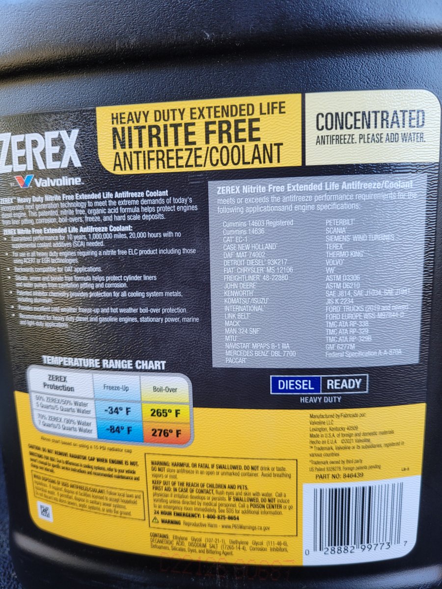

I may be wrong, but the Motorcraft Yellow is POAT, while the Zerex Yellow is HOAT?
Whether they can be mixed/exchanged even if they do meet the Ford Coolant Specifications (WSS-M97B57-A1, Yellow), & (WSS-M97B44-D2, Orange), Would be great to confirm without any doubts, in my Opinion.
The Motorcraft Ford Coolant document I posted earlier states that both Specs are compatible, assuming that document is real since the link was a google search Origin instead of being from Fords website, Motorcraft Yellow was originally intended for 2018 or 2019 and newer I believe.
