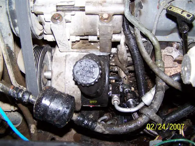

Recently I have seen a few people asking about replacement power steering pumps and a upgrade for the factory unit.
This is what I did on my 91'
This is the pump you want
You will need to pull your pulley off your power steering pump, I got my puller from harbor freight for about $20
You need to do some triming to get the pump to fit the factory P/S pump bracket
The high pressure hose on my 91 explorer did not seat right in the new pump so I used the high pressure off my 84 Bronco2
