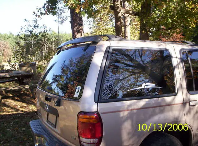

Other than an after market brand from what I've been told is that it is a dealer option and install. Here is a pic of the dealer install that I have on my '98, I've only seen 2 like it in last five years I've had mine so they are not very common.

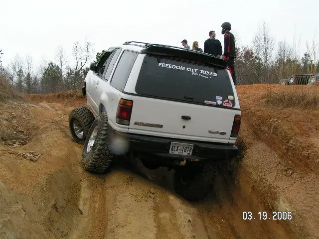

tape going on four years now and I only had to re do it once because I put on a new lift gate.
Tips to make the tape work.
Make sure the area is clean clean clean. Wipe it down with a tar wax and grease remover. Stick it once and only once. Press real hard to get the adheasives to release. Do it on a nice warm day. 60-80 degrees is the best bet.
