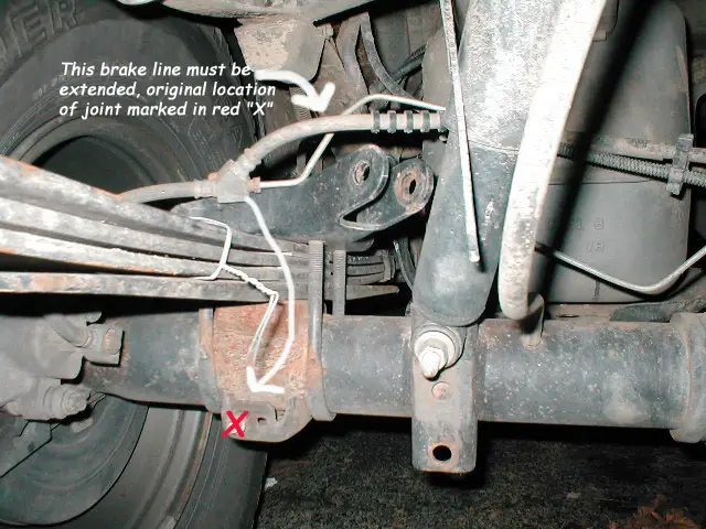

Yomie, your not really risking breaking anything, there is no load difference, just the fact that the axle is below the leafs instead of on top, you will however have to watch out for the break lines, they might need to be extended, and the sway bar might have to be removed, I took me sway off to get max. artriculation, and ill tell ya, I got some awsome flex in my X, in the rear atleast for now, I mounted the shocks to the stock sway bar holes, I reversed the factory shock mounts from side to side and flipped em. it came out better then I expected.

good luck, and make sure you watch the break lines, test with the truck under some flex to see how the break lines hold up.
Hey Lizardtrac, could you take a pic of this mod, I have seen pics of your web site... your flex is great!! awesome man!! I was planning to mount the shocks in the sway bar mounts but with spring unde axle, but after that pic, maybe some SOA will be considered.... do you have any closer look???
Thanks in advanced!!:bounce:
here ya go,... just snapped it.
the drivers side

When you did this mod? are you sure about the mounting holes?? are the holes strong enough to get a heavy off road trip??

I dont have a side view pic yet, its dark here so it wont come out so good now, the front is about 4" lower then the back, its not that bad, the holes in the rear for the shocks willhold up, ive been off road many times with it like that, along with many 2 hr trips to and from PA. ill try to get a side view pic up soon.
Sway bar mount bolt holes
The point is, Springs over the axle! the shocks are to long to make them fit on the upper hole, so I have to mount them at the lower hole. After some flexs, I decided to mounted them back at the original hole, and try it again, the flex is about the same.
I realized that the springs, get max articulation and the shock don't, so we are talking about revolver shackles here...then I will mount them back at the lower holes, that will show all the lenght of my shocks!! I have seen some toyo with revolver, they flex almost like lizardtrac's X but with springs under the axle...

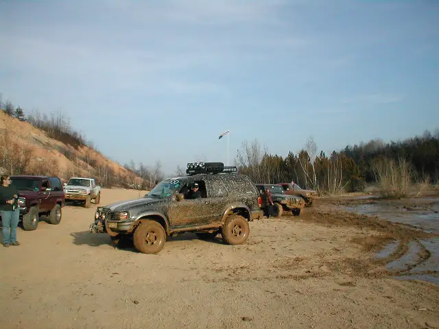

merry christmas oso_polar, this is a bit more tilt then usual due to extra weight in the front
Thanks again...
It looks like springs over arched or something like that, maybe I can handle that look!!:eek: and if that give that articulation, woo hoo!! with that articulation, you can get on places with 4 wheels on the ground instead of loosing power with one wheel on the air, I dont care if the front dont have that travel, but with the rear it will certanly do, after I get my tires I will take this mod!!
Thanks again for the pic!! it look awesome... merry christmas to you too...
