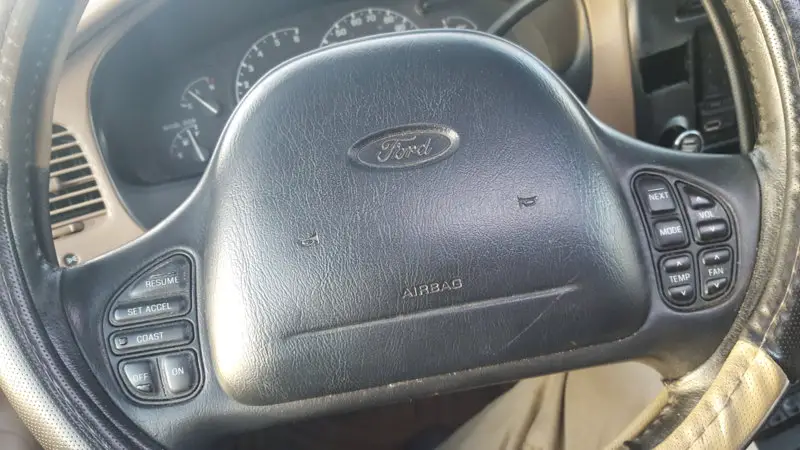

You can swap many Ford truck wheels into the Explorer, but as said you have to have the clock spring that matches it. The wiring can be modified to regain function of both the horn and CC, it's just matching the wires and splicing those together. They are tiny wires, so it will take patience and soldering the horn wires would be smart.
The cars use different mounting holes in the wheels, a slightly different shape. I don't know if any will swap car to truck etc, but simply be off center. I saw some pictures but never tried to mix them. But the buttons and functions can be the same car to truck. I have those same two spoke wheels for my trucks and my 92 Lincoln(a 2003 Marauder wheel and column).
