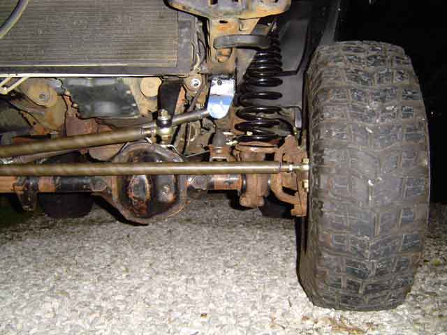

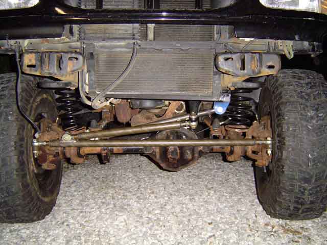

bump steer significantly reduced. Will be great when I get my shocks on. And I am puting a bend in my drag link a bit so it is level coming off the pitman arm...
Got a drop pitman arm and a duff trac bar drop bracket...

Have you flexed it with the new trac bar yet? 15" of wheel travel, that's nice! Now I have a goal to shoot for. Not that I think a leaf spring system is better because I really like the EB suspension and Dana 44. I think you did a great job.
just out of curiosity why are you getting both drop pitman and drop bracket? it looks as if you could get away with just the drop trac bar bracket to make the arms more parralell... or are you trying to get them both at a lesser angle?
